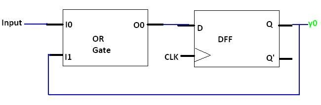

I'm not sure whether the following scheme is valid:
untitled-jpg.45963
As now, instead of having the input to be steady for Tsetup before the clock's rising, it needs to be steady for Tsetup + T(OR_GATE).
(Where T(OR_GATE) is the time it takes to the OR gate to output a valid value).
What do you think please?
Thank you.

For that circuit, once the DFF Q output goes high after the CLK pulse due to a logic one on the input, it will stay high independent of the further state of the input. Is that what you want?
If the clock and the input are asynchronous it really doesn't matter. Sometimes you will get it sometimes you won't.
Yes,
My main goal was to design a circuit which outputs 1 for a single clock, when the first '1' is received in input, and then it always outputs '0's.
So I was intending to connect the output of this circuit to the input of a differentiator.
As I said, your circuit will output a "1" and then stay at "1" until reset or the power is removed. But if it inputs to a differentiator that may be ok.
To do as you want, you could change the OR gate to an AND gate and add a latch between the FF output and the input to the AND gate.
Thanks for the confirmation.

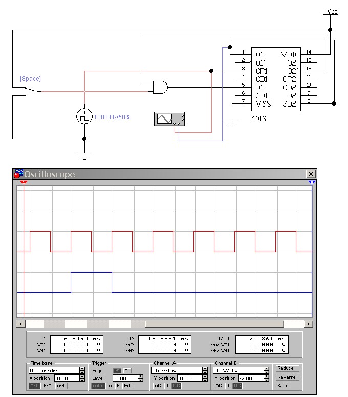

Below is a simulation using a 4013 dual-D FF to generate only one output pulse with the input goes high (the Space switch). I used the second FF as a latch.
Note that all unused inputs must be connected to ground, which I did not show. Also you will need a signal to initialize both FF's in the desired state when powered up (CD1 and CD2 momentarily high, then low, which could be done with an RC circuit).

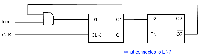

Hey Crutschow.
I was trying to draw your schematic:
aaa-png.45992
Did I draw it correctly?
And, What connects to EN of the D-latch?
Thanks :)

Your schematic is not correct. Q1 goes to the "SET" input of the second FF.
I don't know what "EN" is. There is normally the "D" input, the "CLK" input, and the "SET" and "RESET" inputs.
Just follow the schematic I posted.
I thought that a D-latch is a Latch with EN and D entries.
I got it now.

Don't know what that means. As my simulation shows you get one pulse out when the input goes high. After that it makes no difference what the input does.
You are right! it's brilliant :)
