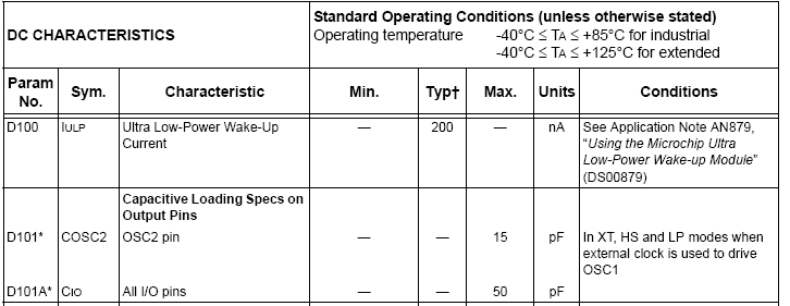

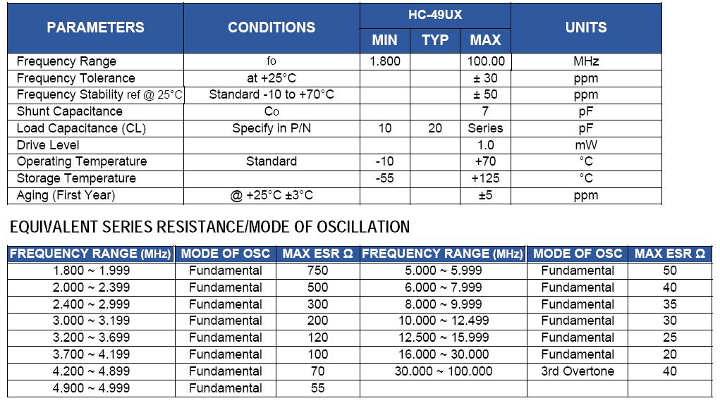

Im trying to figure out how to connect a 4mhz crystal to a 16f883. Ive gone through the datasheet for the 16f883 and on page 66, figure 4-3 It shows the crystal installed at OSC1 and OSC2 with 2 capacitors and a resistor. What value capacitors do I need to use? It also states: "A series resistor may be required for quartz crystals with low drive level" but does not state what that is. Ive attached the only information in the datasheet for the crystal Im trying to use...can someone help. Thanks!
A: Why would you want to connect a 4Mhz oscillator to the 16F883? It has an internal oscillator that goes up to 8Mhz.
B: Don't worry about the resistor. You'd probably know if you had a low-drive crystal.
C: "Drive level is the level of power dissipated in the crystal as a result of the operating circuit. Rated or test drive level is the power at which the crystal is specified and any deviation from the rated level will affect the crystal performance: therefore, the actual drive level should reasonably duplicate that specified. "
D: Around 4Mhz should use 15pF capacitors. From 1Mhz up, you pretty much just use 15pF capacitors for the oscillator.

Do I need to use the caps if I use the internal oscillator?
ok..no caps if using internal oscillator. Now, would the internal oscillator be able to reliably operate an LCD. I read somewhere that they (internal oscillators)may not work correctly under different temperature and pressure conditions. If this is not the case then internal it is :)
The internal osc is very good, fine for an LCD and most other things including serial communications. It's not good for a real time clock though. About 1% from the factory on most modern PICs including the 16F883.
