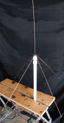

The physical length of your "antenna" element is 80 cm (about 1/4 wavelength) because that portion is completely exposed. The outer surface of the outer conductor (the shield) of the remaining coaxial cable length will substitute as a poor ground plane (reflector). It will not work optimally because the long coaxial shield is not an optimal ground plane. There will be wasted radiation along the entire length of the coax since the shield is part of the antenna, and it will not have a 50 ohm load impedance. What you have is a poor Marconi antenna. Even a proper one has a feedpoint impedance of about 30 ohms which is not equal to 50 ohms.

In the picture, the vertical element is your 80cm wire. Positioned around the bottom of the vertical element, and equally spaced, are four additional 80cm wires that, connected together at the bottom, form the ground plane for the antenna. Each of those four wires is angled downward from horizontal at 45 deg angle. The shield of your coax connects to all four angled wires. The center conductor of your coax connects to the vertical element. That is a respectable antenna.
