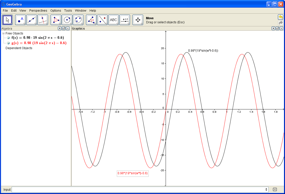

Use Geogebra
Hi.
This is how MrAl's formula looks when drawed in Geogebra.
Just remember to replace ω with "2 Π".
Nb: space is a valid symbol for multiplication in Geogebra.

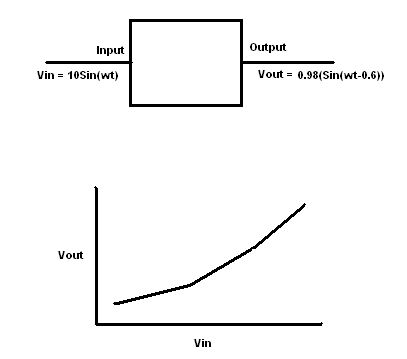

Are you trying to plot the output of a system against its input, as shown in my attachment.
Or are you trying to plot voltage against time?
Please clarify.
