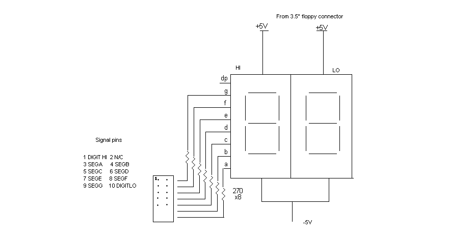

My Circuit - help needed.
Ive attached a gif file
Things I dont know
Will the 5v Rail from the PC floppy overload this?
When digit Hi is selected output should go to the Hi LED when low is selected it should go to the Lo LED, how do I acheive this and will it result in one digit going out when the other is lit?
Do I need a LED line driver to do most of this work for me ?
Is it appropriate to take the -5 volts output from the LEDS and run that to the ground on the floppy connector.
I want to ensure that none of the voltage / current from the floppy power gets to the 10 pin data connector as I beleive its CMOS 3.3v if im using the 10 pin connector data lines to feed the signals on the LEDS will they receive any voltage or current from the 5v floppy connector and if so what can i do about it ?
How do I ensure that only the appropriate LED is getting the data ?
Thats about it I think.
If theres something ive forgotten please let me know.
Cheers in advance.
ok, a little googling helped me understand what you are doing. more context would have helped a lot. p80p is an onboard diagnostic 2 digit LED display driven by the bios (POST code, I dunno). I assume that you are planning to take the p80p pins and connect them to the display. what motherboard are you using?
so, that said, your diagram is wrong. you don't connect the display to voltage or gnd. the segment pins (or hidig/lodig) have all the driving voltage. forget the floppy cable. Hidig and lodig are the common pins for the coresponding digit. the segA-G will be connected to the same segment on both digits. the BIOS (or ?) will select the digit via the hidig/lodig pin and then power the desired segments. it will alternate rapidly between the two digits so they will both appear to be illuminated at the same time.
You need to understand whether the p80p port expects a common cathode or common anode display. do you have an actual 2 digit display in hand?? can you point to where you are getting this information?
I think, from what i read, that the p80p is driven with 3.3V. so you will need to calculate the resistors based on that and forward voltage of the display segments. this will be in the datasheet. If you don't have a datasheet, for red, use 2V and green or yellow, use 2.2V. the resistor is used to limit the current. I'd probably pick 20 mA. the resistor is calculated via the formula R = Vf/I = (for red) (3.3-2)/.02 = 1.3/.02 = 260. choose the next higher standard value resistor. 270 will be fine for red. don't use blue LEDs - they require more than 3.3V. note also that some super bright leds take higher voltage and/or current. I'd would not use them here since the current capacity of the p80p circuits isn't clear.

safe? yes. accurate, no - the cpu is scanning the 2 digits so if you put an ocilloscope on the pins you would see a pulse train. It all depends on what your meter does with that sort of thing.
measure between the pins and gnd, not -5V.
look here for a description of driving 7 segment displays including common cathode vs common anode. https://www.melabs.com/resources/articles/ledart.htm

I'd like to thank you guys for your help , my circuit is working now and I found what the major hassle was.
The data sheet for my 7 seg leds states : TOP
A B C D E
F G H I J
but what i found out is that this is not the pin assignments from looking at it from a top down view i.e being able to see the leds, all they are actualy indicating is what is the top of the device and all the pinouts are actualy structured from the bottom thus what I wired to the spec above should have been E D C B A
J I H G F
I suppose im realy very luck that C and H were both commons.
What gave it away ? the decimal point kept comming on and i hadn't wired it in. :D cheers all ill be back when i work on the next thing to break :D
