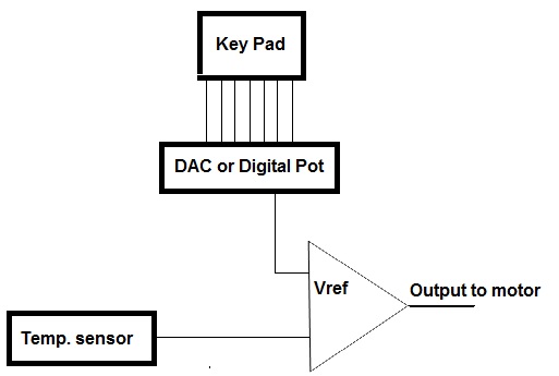

the motor will be used to roll a canvas cover (75" by 74"). This cover will be on the roof so it will be exposed to elements such as high winds, therefore the motor has to be a little bit strong. The problem is that i want to keep my project as low in power consumption as possible. I think an AC motor will consume less power since no transformer and supply will be needed, but will it be possible to control an AC motor with low speed? are they more expensive then the DC motors?
Regarding the DAC and digital pot, the current will be approx 50mA not more and the higher the resolution the better... but what i want to know is a comparison between general DAC and digital pots.
thanks again for your help
What is the expected actuation rate of the cover? (number of cycles per minute/hour/day/week/month)
I want the cover/shutter to fully close/open in about 10 to 15 seconds. The DAC or digital pot will be used since the cover will close when a pre-set temperature is reached. A voltage comperator will compare the voltage of a temperature sensor with the pre-set temperate. To set the reference temperature a 4*4 key pad will be used, therefore i need to use a DAC or a digital pot to convert the inputted temperature to analog (for instance if i want the shutter to close at 24oC, i press 24 on the key pad and the DAC or digital pot converts it to 240mV which is equivalent to 24oC) . The bigger the resolution the better since it will more 'steps' and be more accurate.

I think you are getting mechanical and electrical issues mixed up.
If you need a force to prevent the shutter from moving don't use the motor for that - use a mechanical system. The simplest mechanical system is probably a worm gear which also provides a large torque increase (speed reduction) so a smaller motor would work. Alternatively you could have a mechanical pin lock (solenoid operated?) or an over-centre lever mechanism.
You will need a DC supply for your control system and that will need to be derived from mains power so why not use a 12v DC motor system. The 12v battery could be charged from the mains by a cheap 12v trickle charger and none of the stuff you make would have to work at mains voltage.
Normal electric motors rotate freely when they are disconnected from the power. I suspect that any that don't have expensive mechanisms inside to act as a brake.
ETA You could use a potentiometer to allow the user to set the temperature (which sets the threshold voltage directly). When you have it working just add a suitably calibrated dial from a piece of card or plastic.

I think a DC motor with a worm gear (as Robin2 said) will work fine for this application...
Why a Keypad for temperature input?
The original design was with an UP and Down buttons, but the lecturer told me to use a key pad instead to set the reference temperature.
