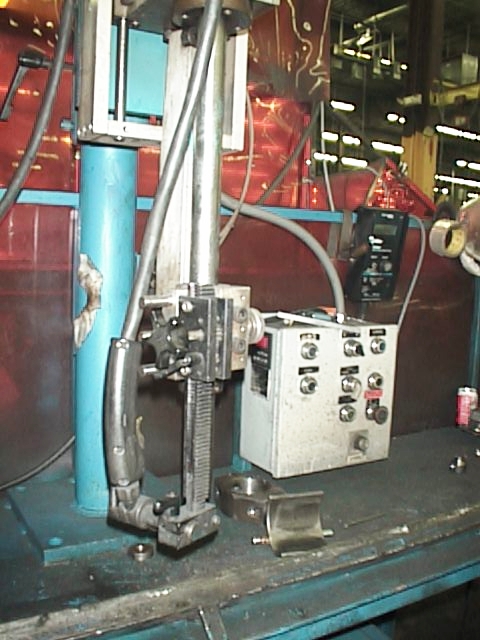

Automated Port Welder
This is a "port welder" I designed and built that welds the ports where the hoses attach to a hydraulic cylinder. It is programable to make multiple passes, overlap, and return to "zero" when done.
I uses any hand held mig gun.
It is controlled by a cheap programmable electronic counter ,Red Lion Legend, and Red Lion optical encoder.
Bill
