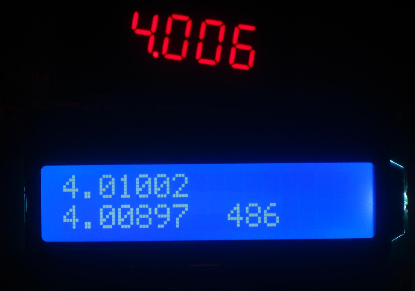

Hello there,
Here is a quick comparison of the ADC in the Atmega 328 chip in an Arduino Uno and a 16 bit ADC separate chip. It would be nice to hear about other people's uses too, as to any comparisons they performed.
The Uno uses the +5v reference available on the board, which is not as stable as the 16 bit ADC internal reference, so the difference in readings is often more off by about 3 or 4 millivolts, and as high as 5 millivolts. The only calibration for the 328 chip ADC is done by measuring the +5v supply and using that measurement as a factor in the conversion from the ADC code to the voltage displayed.
There is no calibration for the 16 bit ADC, which is found to be very close to a measurement with an expensive meter, although some calibration would help there too.
The attachment shows three readings, although the top 'red' display should really be ignored because that was taken with the ground lead on a different point in the circuit.
The top reading in the blue display is the 16 bit ADC, and the bottom reading is the 328 chip ADC, and the number to the right on the bottom in the blue display is just the sample count.
The conclusion was that the 328 chip differs from the 16 bit ADC by up to 5 millivolts, but the power supply on the Arduino board was found to vary, so a better reference voltage would probably help there. In any case the +5v has to be measured in order to set the factor in the code correctly, or at least close. If a different reference is used that would have to be measured.

To really compare, it would be nice to use same reference for both converters. I am sure the vref is the big factor in your results. Can the Arduino use an ext vref?

Yes, but using the same for both is not possible right now because the 16 bit chip has a built in reference without access to any of it's pins.
I tried the 1.1v reference internal to the 328P chip. It's always partly a matter of calibration anyway though. Using the 1.1v reference i'd have to connect two resistors to the ADC input so i can read up to 5 volts. They would not be exact either, so i'd have to do some sort of calibration anyway i guess.
Also, i could not find a temperature spec on the 1.1v ref, although it is bandgap.
The initial accuracy of the 1.1v ref is also not very good, so it has to be measured with each chip in order to use it effectively.
The readings without resistors and calculating the code factor when using the 1.1v reference, the readings come out within about 2mv of each other.
Mike you are right though, using the same reference would be the only way to really know for sure. That would mean both factors would be the same so any variation is due to the chip itself.
What i could test though is the variation over the full input range, like 0 to 1v or 0 to 5v or whatever the reference is set to.

A much better comparison would result from sweeping the input voltage slowly to both ADC converters and reading them simultaneously, and logging both ADC values at many points over their range. By plotting one ADC reading vs the other, you can get a pretty good gain/offset plot over the entire 0 to 5V range.
Even better, use a third method to actually measure the real voltage at each test point. Best I could do would be to use a precision 10-turn pot connected to a stable lab supply, and then read the resulting test voltage on my 4 1/2 digit Fluke DMM. Use those readings as the x-axis of a plot, and plot both ADC readings on the y-axis of the same plot... That would show non-linearities, discontinuities, slope errors, offset errors...

Very good idea. I was using a 10 turn pot but a controlled sweep would be much better. I dont even need every single nano volt either, just maybe several steps, so a stepped wave would be good too i think, giving time for each ADC to settle.
I want to use this for some general purpose instrumentation so i want to know the limits. I dont even think i tested the PIC ADC's this extensively but i never had a problem so i didnt worry about it. Now i wish to look a little closer and make sure what i am reading is what is really there :)
I'll throw a little circuit together for the stepped wave and hopefully have some results by later today or tomorrow morning.
