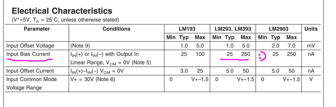

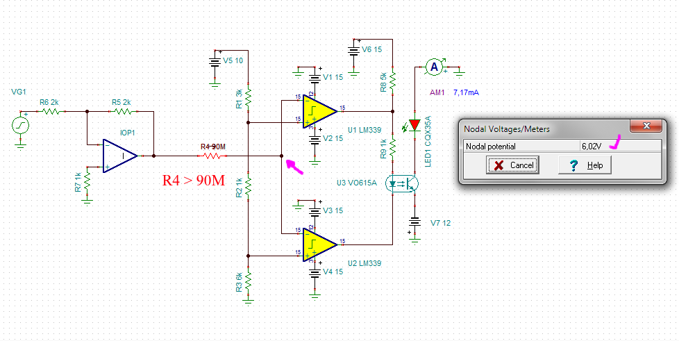

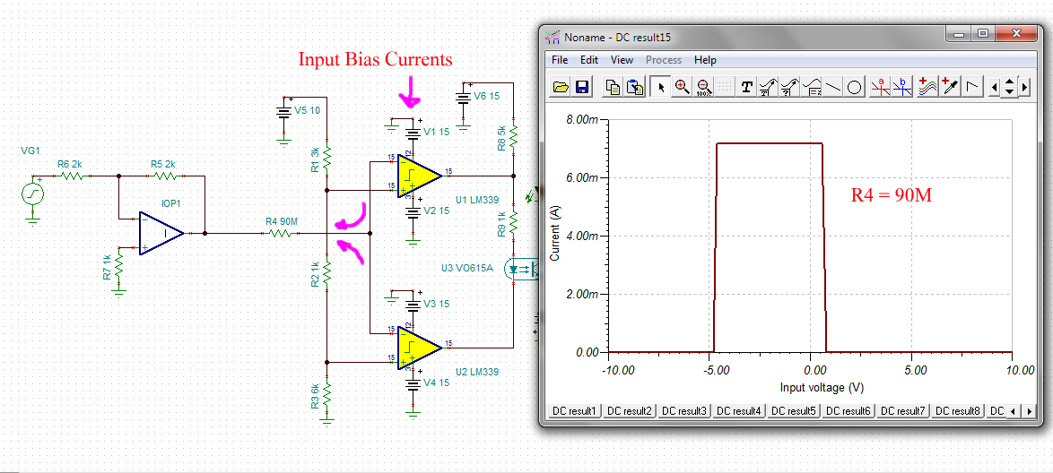

3... R4 > 90M (comparator input bias current) :) :)

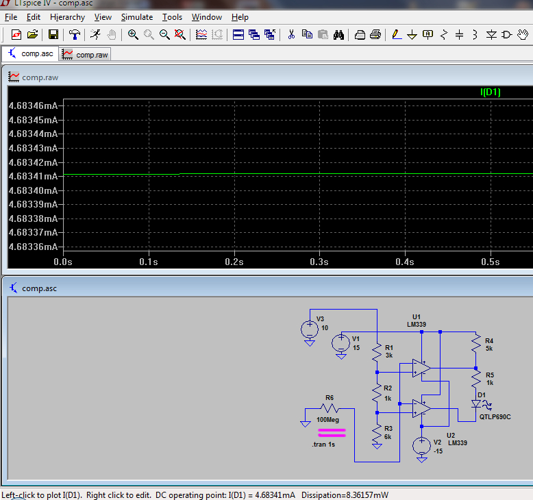

Your simulator gives an answer different from than the one I used (LTSpice). I wonder which is right and why the difference ?
To get to the bottom of this, I have just completed a practical test of the relevant part of the circuit (ie R5, R6 & R7, U2a, U3b, R8 and R10. Instead of +-15 volts dual supply I used +-12v since that what I have to hand. Instead of an optocoupler LED, I used an ordinary 5mm red LED. I used +10v w.r.t. ground to feed the divider chain R5, R6, R7. The inverting inputs of both comparators were joined, and were unconnected to anything else.
I could not get the LED to light.
It would be helpful if someone else would try this practical test to confirm or deny this result.

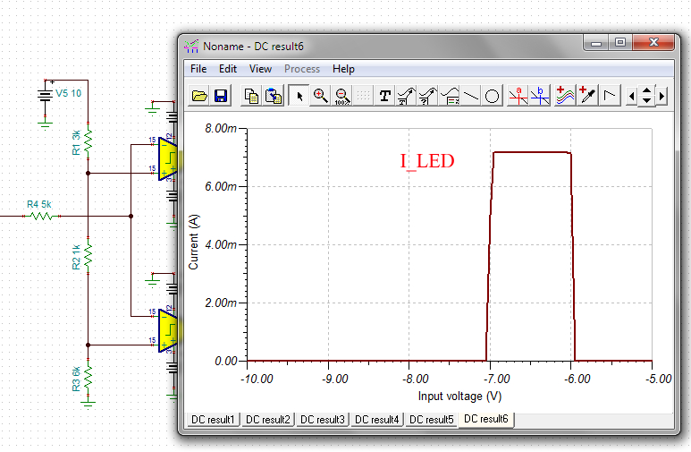

If the question is when does it turn on normally, then we have the following...
The LED turns on when the opto turns on.
The opto turns on when comparator pin 2 goes high and pin 1 goes low.
Pin 2 goes high when pin 4 goes lower than 7 volts.
Pin 1 goes low when pin 4 goes higher than 6 volts.
Statements 3 and 4 above taken together means that the opto and thus the LED turn on when the input at pin 4 is between 6 and 7 volts.
Pin 4 is between 6 and 7 volts when the input is between -7 and -6 volts, because the input amp is an inverter.
Thus, the LED lights when the input is between -7 volts and -6 volts.

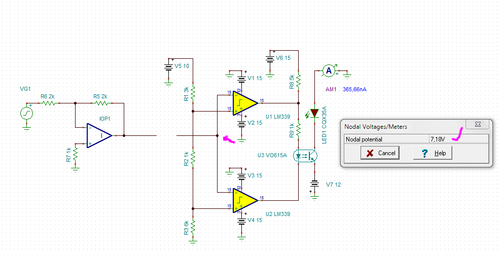

To turn the LED on with 0v input however (a failure mode) could happen if:
1. The output of the opto was shorted (more likely).
2. The comparator was bad.
3. The op amp was bad.
Since #2 and #3 would require very specific kinds of failures, the most likely is the opto though.

R4 changed value to greater than 90 Megaohms is easily dismissed by measuring the voltage sweep at the junction of the resistor and the two comparators. Resistors increasing to that value, from 5k, is unlikely.
