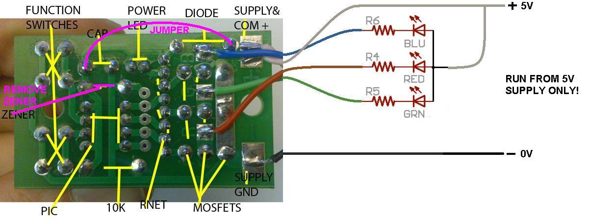

The whole circuit is designed to run from 12-15v and i dont have a schematic for it BUT.. have just made a crude layout diagram from a photograph as its only a one sided pcb.
I hope it helps for those of you that are clever enough to understand the circuit from it, i guess there must be some way of switching a lower voltage direct to the leds and leaving the 12v supply? By the way it powers common anode rgb arrays.

You could easily convert it to work on 5V and use the ac adapter I posted above or a similar one.
Or add a 5V switching regulator circuit to power just the LEDs.
Or you could simply just use higher wattage resistors to dissipate the heat.
What could I do to? would it just be a case of separating that earth and cutting the track from the circuit supply one, then applying a lower voltage to the supply com?
thanks for your help
What could I do to?
If you mean modifying the circuit to use the ac adapter I posted above, then you would add a jumper and remove the zener. Once this "purple mod" is done, you can only run the board from 5V and the on board LED will not light up. 12V will destroy it!

Thanks so much for taking the time to do that! Very much appreciated!
I’m in the UK so might not purchase that exact 5v adapter, but I guess any 5v switch mode supply would do? Could I use a 12v-5v dc-dc if there is such a thing available?
Thanks again for your efforts, I’m looking forward to trying the 'purple mod' :)
Yep. Any 5V regulated supply should work as long as it has enough current capability for the number of LEDs you intend to drive at once.
Yes, and they are available. If you used one, you wouldn't need to modify the driver PCB as you could feed 12V to the PCB and 5V to the LEDs.
Here is one from Farnell, but you may be able to find a similar one cheaper elsewhere.
