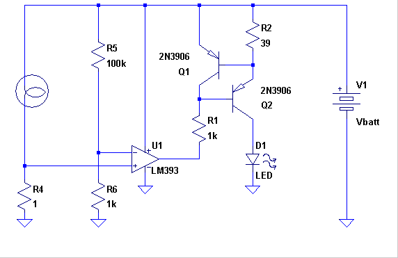

Here's about the simplest circuit I can come up with that works over a wide range of supply voltages (3V to 36V) and lamp sizes. I don't actually have any lamp specs, so you might have to change some resistor values on the input side. The output drives about 18ma into the LED, relatively independent of the supply voltage. The LED forward voltage needs to be less than the minimum supply voltage by a few hundred millivolts. If one end of your lamp is grounded, this would have to be re-thought.

thnx succesfully builded one ... Vcc = 24 Vdc and the 1ohm resistor is replaced with 0.5ohm 5watt resistor
Thanks for the feedback. What is the rating of the lamp you used?

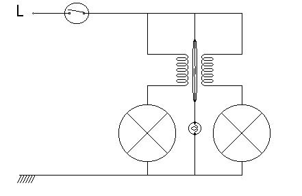

This is the simplest one ive seen,
its was for vehicle lights,
intended for pairs of lights.
The one i saw was home made and only had six or seven turns
for each of its lamps.
I would guess a single might be made using a piece from a
broken magnet, but thats just a guess.
Regards, John :)

John1, that is excellent! For an LED indicator, all one needs to add is a resistor in series with the indicator lamp.
