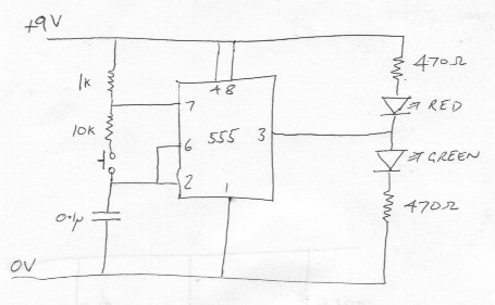

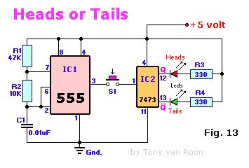

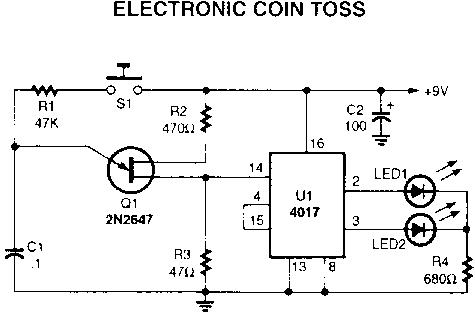

OK, I’m working on a “Coin Toss” project. And I have two schematics:
The pictures are at the bottom.
# 1 Uses more parts so not only will it be more complicated, but it will cost more too. The only good thing, is that it runs off of 5V and # 2 runs off of 9V. However, that’s even worse in my case, because they don’t have 5V batteries, as we all know. So, I’ll have to use a voltage regulator, which is big, and needs too be heat sinked. (And of course, will be even MORE money.)
# 2 I would much rather use this one, because… well, I won’t go into a big explanation, so let’s just say it’s because the reasons above do not apply. But the ONLY problem with #2, is that I don’t know what transistor to use. I know it has it right there under the transistor it the schematics, but I can’t really find that one. I use Digi-Key, and their catalog doesn’t show part numbers. So can someone tell me a good transistor to use and give me the Digi-Key part number please? Thank you in advance because I know you guys will be able to figure it out. :wink:

Here's some tips:
The transistor: Any UJT (unijunction transistor) will do. 2N2646 and 2N2647 are the most common.
The first schematic: You CAN run it off 9V, and you don't need the 7473. Here is a revised schematic.

Are you sure?
Phasor
Are you sure your revised circuit will work as intended?
won't it always stop with the red LED lit?
Relay strange it realy works!? :shock:
I simulated the circut in Crocodile Tehnology and it worked!???
Yes, it will work. I don't see any problem with Phasor's circuit except for that 1k resistor. It should be atleast of 5k. While designing, that resistor is always taken greater than 5k and accordingly all other component values are calculated.
In practice, capacitor is assumed first and R1 and R2 are calculated on basis of that. But if R1 comes out to be less than 5k, capacitor value is altered to match the requirements.
Yep , Phasor's circuit works fine, i just tried it out on my prototyping board.
But i made some slight changes ;Perhaps its just the type of LEDs im using, but I noticed that when one LED is on the other LED ,which was suppose to be off, glows dimly. So i replaced the 470 ohm resistors with 1K resistors.
I also replaced the .1 uF capacitor with a 4.7uF, so that you can see the LEDs flashing at a high rate when the pushbutton is held down. This makes it abit more interesting.
If you use the "no-latch" circuit, won't the duty cycle asymmetry cause more "greens" than "reds" after many flips? With a CMOS 555, this can be remedied by not using pin 7 or the 1k resistor, instead returning the top end of the 10k to pin 3. The bipolar 555 "high" level on pin 3 does not reach the supply voltage, so asymmetry would still exist.
With either CMOS or bipolar, I suspect that leakage will eventually cause the output to flip on its own. This won't happen with a latch (7473 or 4017).
That's why I chose the 1k much smaller than the 10k, to make the duty cycer close to 50%. But statistically speaking, yes, there will be more greens.
This is true also. Perhaps a low-leakage cap should be used.

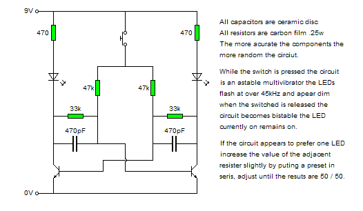

This is an old thread but your post is usefull so it doesn't matter.
You really need 50% duty cycle which could be done with a CMOS CD4060 timer oscillator and counter IC.
If you want a cheap circuit then try this circuit, if you use close tollerance capacitors and resistors then the duty cycle should be near enough 50% not to matter.
