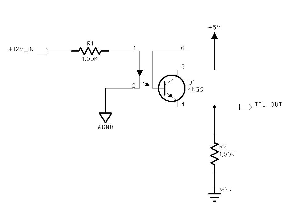

im currently in the stage of making a coin operated pc, i want to interface the coinslot using the parallel port. my problem now is that the coinslot gives a 12v 50ms pulse, which is the source of all my trouble because in order for it to be parallel port compatible it has to be converted into a TTL signal, can any one help me find a way in converting this signal into parallel port compatible.
i already have a software that pools the parallel port for a signal from the coinslot signal and unlock the pc when a signal has been detected.

You could use a simple transistor based circuit - the 12V would drive the base of an NPN transistor whose collector is connected to 5V via a resistor and whose emitter is connected to a common ground. The parallel port pin is then connected to the resistor / collector junction. Google for 'transistor switch'.
An alternative idea is to use an optocoupler, same principle of operation but using an isolated input, which would be superior. Google optocoupler or optoisolator for details.
Even simpler is a straightforward mechanical relay circuit.
Be aware though that both transistor approaches would invert the signal you're measuring, unless you use two transistors.

since im not really very good with electronics, i was hoping that maybe you could give me a suggestion for the best opt coupler and how to make the connections...

Take a look at **broken link removed** and perhaps https://www.electro-tech-online.com/custompdfs/2009/02/optocoup.pdf.
Relays are even simpler to understand and aren't electronic, they're electromechanical - maybe you would be better off going that route.
thank you very much for your help, i tried more googling and i found a diagram utilizing pc817 optocoupler....
thank you very very much
i have 1 thing i im not sure about the diagram that i found. what is the voltage rating for the C1 1nF capacitor.
Well, it only needs to be a 5V cap but since this is probably going to be a ceramic type you'll find that even a 10-50V rated cap will still be very small. So as long as it's 10V or higher you're in the 'safe zone'.
That's a suitable circuit though. Just be aware that when you put 12V on the input, the parallel port pin will read 0V and vice-versa.

- OR - even simpler why not just a simple voltage divider... 6.8k over 4.7K??????

The beauty of using opto isolators is that you don't have to worry about transistor base bias levels, so you can insert the collector/emitter anywhere you need to.
Here is the same circuit in non-inverting form. (I omitted the cap but I would put one across the resistor).
