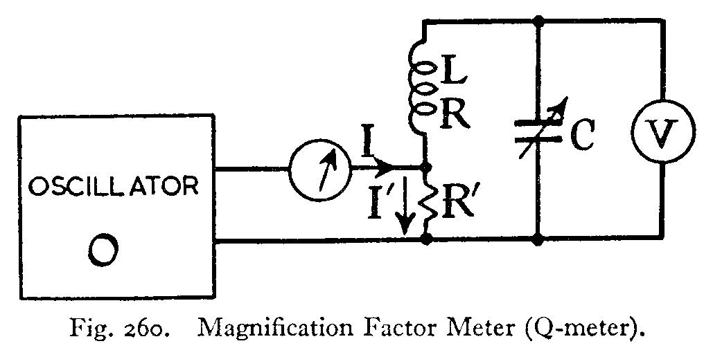

A Q-meter is a combination of an oscillator, a voltmeter and a set of calibrated variable capacitors. Usually there is a set of calibrated plug-in inductors, or you use your own inductor ie the device under test.
It is set up so that the capacitors and coil are connected in parallel.
There is usually a low value (1 ohm) resistor in series with the capacitors, the oscillator is used to inject the excitation current into the LC circuit across this low value resistor.
The voltmeter measures the voltage across the capacitor.
From memory, the Q of the circuit is then the ratio of the voltage across the capacitor to the voltage across the 1 ohm resistor.
All sounds a bit weird if you have not seen one before.
Have a look at the circuit attached here which I have cut from an old textbook.

There are many way of measuring the Q, you could also connect the capacitor in parallel with the inductor and a current sense resistor in series with them both; if you know the voltage across the voltage across the resistor and inductor then you can work out the Q.
