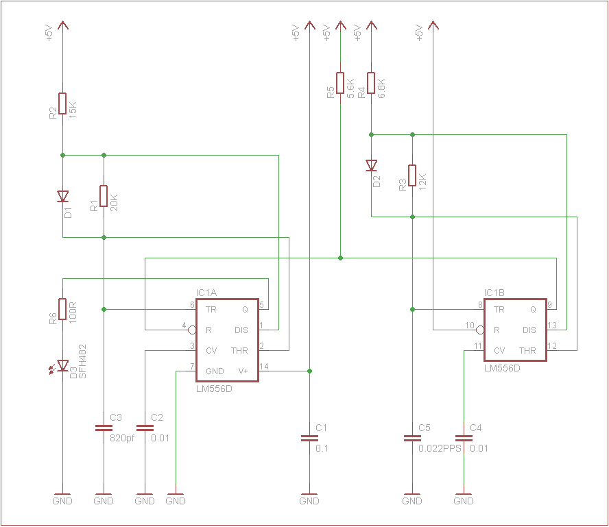

View attachment 61232 this is transmitter ... and then the receiver will be construted as in the labsheet data of the tsop4p38. and the output will attenuate two motor power window using this motor driver circuitView attachment 61233.. and now if u all can see....can this circuit make my applications works? im using about 3 tsop 4p38 to make sure it more acccurate from 1 direction of the transmitter. 3 tsop4p38 using about 3 analog input right? thats why i dont use the 16f877(which before i want to use it)

Here is one example of what I meant by using one 555 to modulate another to give a pulsed sequence of 38 KHz packets. There are many other examples on the Internet.

can i use this circuit for my transmitter....?? do i need modification in this circuit???

The schematic I posted is an example of how to use one 555 to modulate the 38 KHz produced by another. In that example, the 38 KHz is produced by IC1A. The modulation is by IC1B. The modulation frequency I used was about 800 Hz, and the duty cycle was about 50%. For the TSOP4P38, you need to use a frequency of about 2 Hz and a duty cycle of 24% (as shown in the example posted above). I suspect the 24% duty cycle is not critical, but it is important to use a low frequency, so the AGC will kick in and reduce gain.
I suggest that you design the transmitter first. You might want to use an MCU to do that, since your project seems to be MCU-based. If you prefer to use just 555's, get a circuit for 38 KHz, which you have. Then get a circuit for 2 Hz with a duty cycle that can be adjusted to less than 50%. There are various ways to do that. I prefer to use diodes to bypass resistors in the charge/discharge part of the circuit. Paisley has suitable circuits on his site:
Finally, use the 2 Hz oscillator to modulate the 38 Khz oscillator as in the schematic I posted above. If you have access to an oscilloscope, it will help immensely in getting the timing right.

so my circuit transmitter that i had can be used but a little modification right? with adding one more timer....plus with the 2hz oscillator component....so how to modifide the circuit using the component i just mentioned@you just mentioned...can u show me the real transmitter circuit that can compatible with the receiver....im weak in electronic....if i just keep google. im still get the wrong circuit for my transmitter
I slightly modified the circuit to use separate 555's and simulated it. The green trace is the output from the slow oscillator at about 2.27 Hz and a duty cycle of 26%. You only see the tops of the cycles. The blue trace is the 38 KHz oscillator. It appears solid on this time scale. It measured only 36 KHz. You will have to adjust R2 or C3 to get 38Khz.

ok now then...i must adjust the r2 and c3 only right??? how about the other resistor and capacitor??? to get the 38khz output....how about the oscillator...u said that ur circuit got 2.27 hz oscillator and the duty cycle is 26 %...can this kind frequency of oscillator and duty cycle will compatible the receiver

I just found we can upload asc (simulator files). So I have attached my file to this reply. I have modified the components on the higher frequency oscillator to give approximately 38 KHz with 50% duty cycle. Only one resistor is non-standard, and that can be made by a parallel combination of two, 5% resistors.
