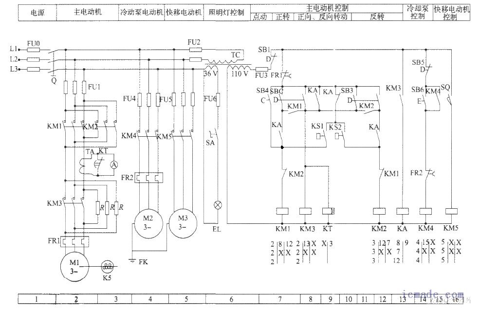

Hello Everyone, I need help with this project. The files are attached. I would like someone to tell me in details, how does the main circuit and the control circuit work. e.g: When Sb1 is pressed, then ... energises, etc etc.

Whatever is this schematic for?
Is this some kind of perverse college homework, or have you just been pushed into the deep end at work?
At a first look through it appears to that:
SA turns on/off the light.
SB1 is the overall machine stop. (Emergency Stop ?)
SQ appears to be a press and hold switch to run motor M3
SB5 starts motor M2
SB6 stops motor M2
SB4 runs motor M1 at low speed/power in the forward (?) direction. Releasing SB4 stops M1.
SBC (?) runs motor M1 at high speed/power in the forward (?) direction. The motor is latched into the run state.
SB3 runs motor M1 at high speed/power in the reverse(?) direction. The motor is latched into the run state.
KS1 runs motor M1 at low speed/power in the forward (?) direction. Releasing KS1 stops M1.
KS2 runs motor M1 at low speed/power in the reverse (?) direction. Releasing KS2 stops M1.
If this is a real machine, do not come crying to me if I am wrong, M3 looks like a serious motor which can do some real damage. :eek:

This is actually a project at school that I have been forced into without good knowledge of the subject. If you see the .doc file, you will get a better idea of the project. Yet, I do not know if this circuit is suitable for the requirements as in the .doc file. lol.
