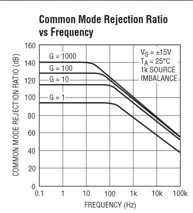

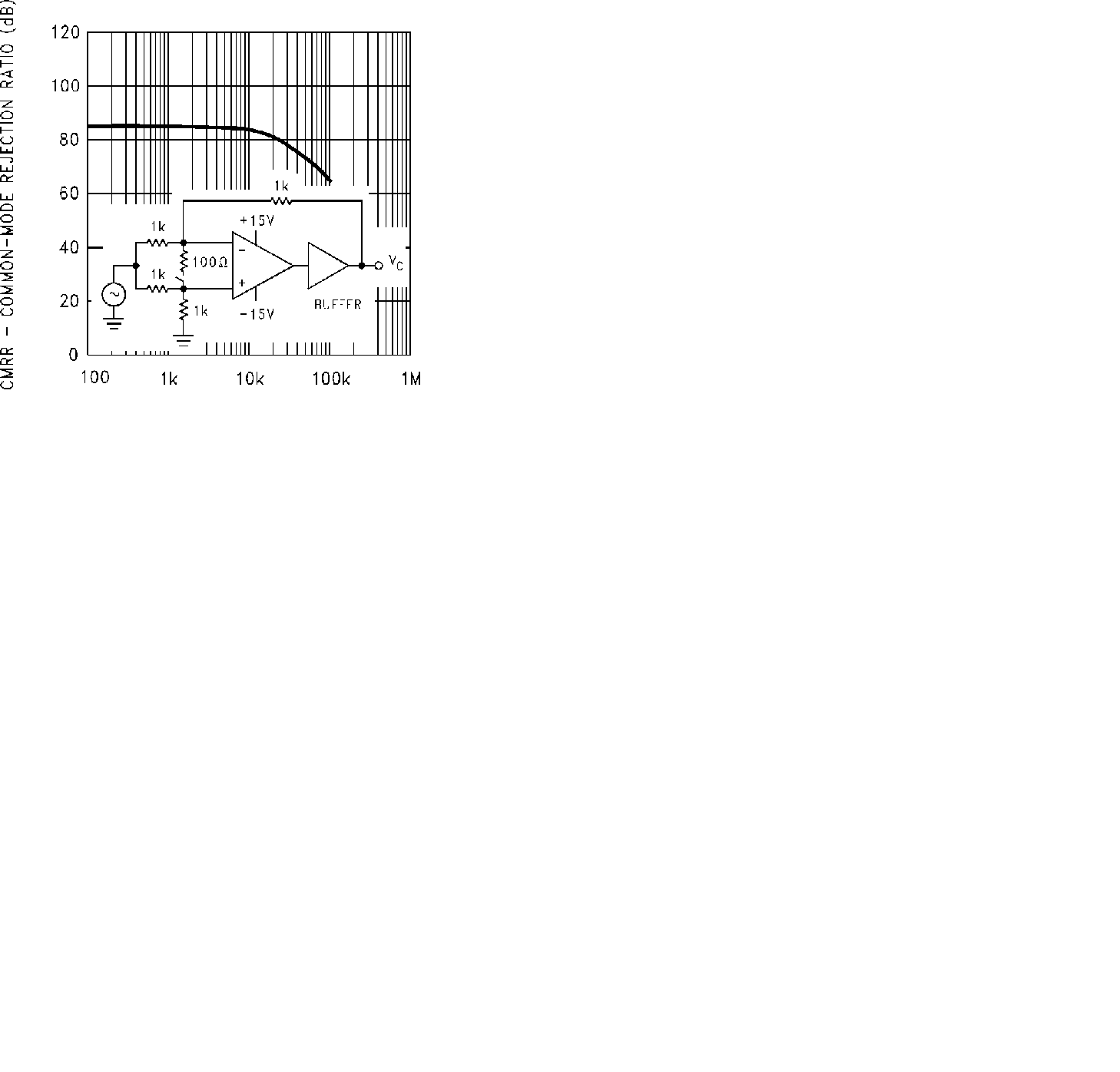

Tie both inputs together and feed a signal in. At high frequencies the signal will pass through. At low frequencies the signal should not be at the output.
It will be interesting to see if the spice results is the same as the graph in the data sheet.
Hmm. But there is a big variation between data sheets as well.

If you tie the two inputs together the input offset voltage can cause the amp to saturate which would give a wrong CMRR, thus you need to be certain that the amp isn't saturated before doing the test. Looks like that's the purpose of the first circuit that ronv posted.

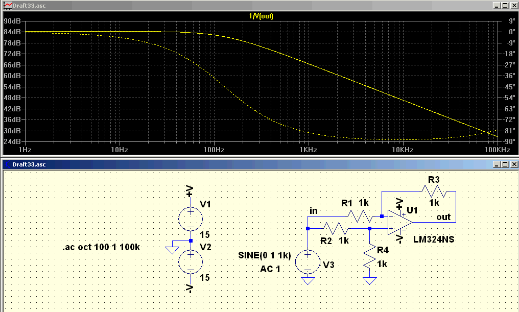

I think this does what you want, using the circuit that ronv posted.
Do an AC analysis with the input source's Small Signal AC Analysis Amplitude set to 1V, then plot the output voltage v(out), then right-click the plot title and change the plot function to '1/v(out)'.
For any other input Amplitude value a, change the plot function to a/v(out) instead.

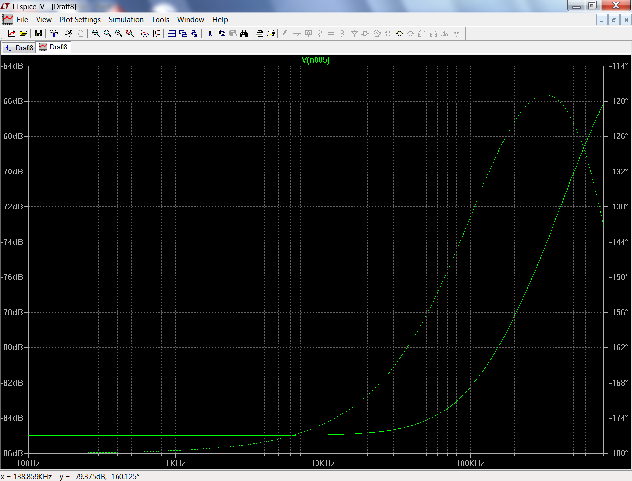

Using Alec_t's circuit. The resistors need to be the same value. Change any one resistor by 5% and see what happens. There will not be any -80db. You are testing the resistors more than the amplifier.
The fist one of these I built, three decades ago, I used .1% resistors.

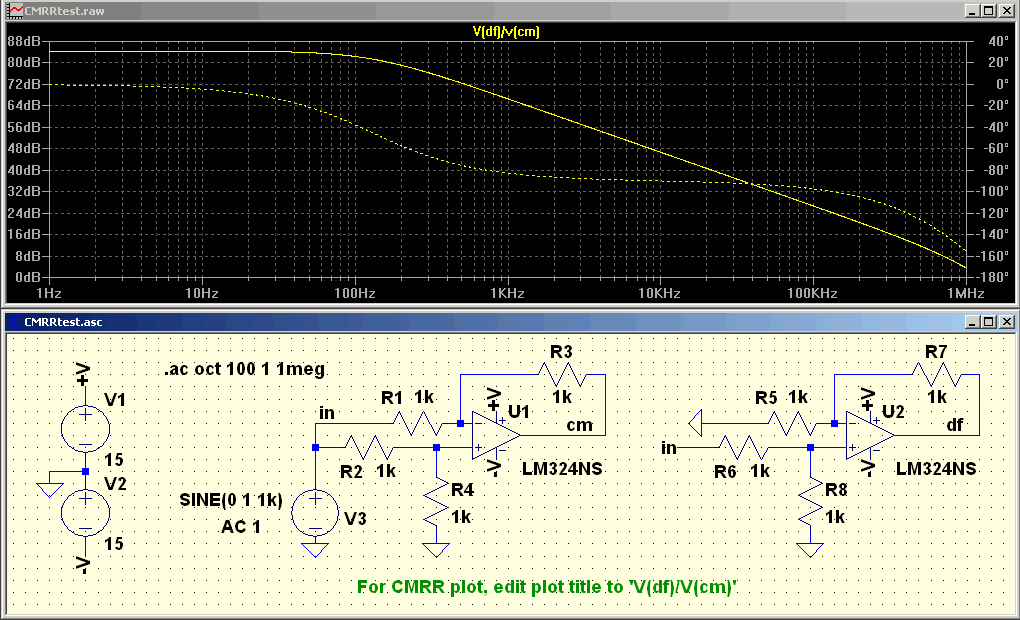

Right. Think I've cracked the CMRR plotting. It's just a matter of plotting V(df)/V(cm):
Edit:
To change the Y-axis units: right-click on the axis, select Manual Limits, select units in the pop-up box.

Yes, that works i think. The circuit we have is much larger so it's harder to create a second circuit, but what the heck it's just spice :)
Nah. Zoom out. Press F6. Click and drag a box round circuit 1. Paste as circuit 2. Bob's your uncle :).
