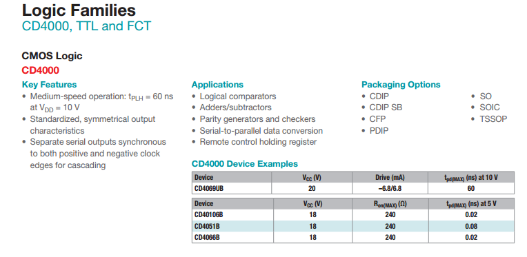

Looking at the datasheets, they have a rough photocopied look to them, suggesting that they are the originals that date back to when CMOS was first introduced. I'm wondering if, over the years, changes in the fabrication process have improved the chips significantly. But if so, why wouldn't they revise the datasheets?
Here's a clip from a 2014 TI document that still shows the relatively low drive capability (**broken link removed** ):

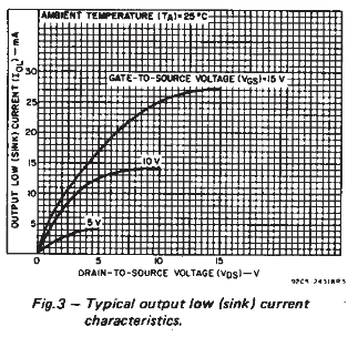

This story is complicated. Sink current:
At 5V supply Vout=0.4V current 1mA typical, 0.51 min and max is ?, (varies greatly with temperature)
At 10V supply Vout=0.5V current 2.6mA typ. 1.3 min ? max
At 15V supply Vout=1.5V current 6.8 2.4, ?
If you allow Vout to be some thing different:
Vout=4V, supply=5V then current typically is 4mA.
So there is (min/typ/max), and (temperature=), and (supply=), and (Vout=) each effect the outcome. Vout could be very high if you are driving a LED not a logic gate.
Okay, that makes sense. So essentially, they are saying that if the output voltage isn't allowed to deviate significantly from 0 volts (logic 0), or 5 volts (logic 1), then the current can't exceed about 1 mA. But if the voltage is allowed to droop somewhat, then the current can be significantly higher.
I think I knew this subconsciously. I've powered LEDs from CMOS outputs many times without any problems. It was only when I decided to look at the datasheet, that I was struck by the extremely low current rating.

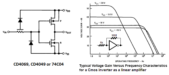

CD4xxx Cmos inverters are frequently used with cross-conduction as a sort-of linear amplifier and they last forever when their low supply voltage causes a low conduction current. The graph shows a typical current of only 3mA and the max conduction might be 6mA. The datasheet says 100mW max allowed dissipation and here the maximum dissipation might be only 2.5V x 6mA = 15mW.
Yeah, I once built a stereo phono preamp out of a CMOS hex inverter as an experiment.
ak
I think it would have very high distortion and cut high audio frequencies if its gain is high. Here is an old test:

So, these numbers definitely support the position that the CMOS outputs are resistive, and not current sources.
See the graph a few posts above? It shows curved lines. A current source is a horizontal straight line and a resistor is a diagonal straight line. The Mosfet curved line is almost a diagonal straight line when the current is low and is almost a horizontal straight line when the current is high. A lousy current source but not a resistor.
