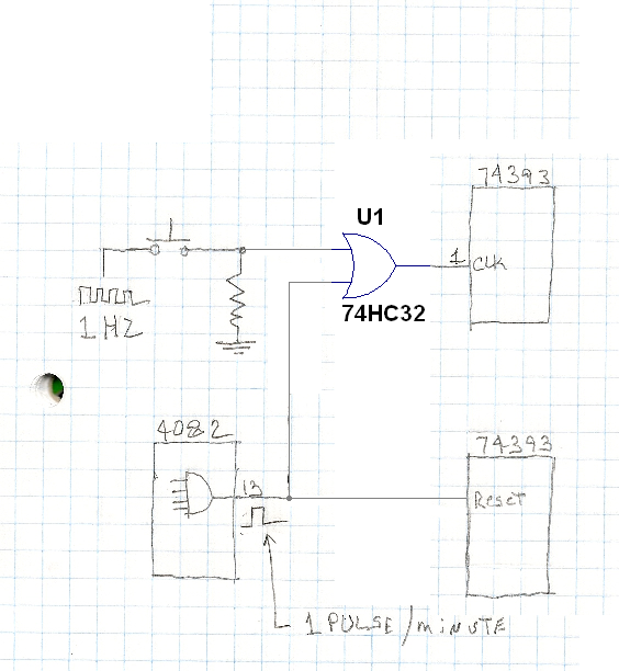

Electro Tech forum,
Thanks for the inquiries.
The diode is placed between a time set switch and the
previous counter's reset pin to avoid resetting the
previous counter.
There is also a 10k resistor between the switch and ground
to prevent the insertion of electrical noise into the counter.
I've attached a schematic, Hope there's enough detail.
Jerryd

Are your counters really TTL, and not CMOS? If so, 10k will not give you a valid logic 0 at the clock input. Standard TTL logic zero input current is 3.2mA @ 0.8V. This would require a 250Ω resistor to GND. Your 4082 could not drive this.
LSTTL input current is 1.6mA @ 0.8V. This would require a 500Ω pulldown. Same problem with the 4082.

Hello there,
It's not good practice to try to drive TTL of any kind with a diode anyway. The input or output requirements get stretched too much and you could easily lose noise immunity...something you REALLY dont want on a clock input.
The right way to do this is with a standard TTL buffer or even an inverter as it doesnt look like it will matter (double check that in your app though).
Second choice would be an NPN bipolar transistor or even mosfet perhaps. You would still need a pullup on the input to the clock (1k good) and then connect the collector to the 1k to drive the input, with emitter to ground, feed the base with a 2.2k resistor from the output of the CMOS.
You'll note that clock inputs are often more fussy than regular inputs.

A transistor inverts. A diode doesn't. That's a problem.
All he really needs to do is replace the diode with an OR gate.
EDIT: Or switch to 74HC393.
Another EDIT: I said that MrAl's inverting transistor is a problem. I just realized that clock polarity is irrelevant for this circuit.
Sorry, MrAl!:eek:

You don't have a problem driving the resets because they don't have the diode and the resistor.
Your circuit should work using 74HC393.
Here is the circuit with the OR gate added.
Some apps do not become affected by an inverted clock, especially when the clock pulse is narrow. If you read back in my post you'll see i mentioned that he would have to check that effect out to make sure an inverter doesnt bother the timing enough to cause a problem.
If one transistor does not work then two will anyway.
I do like the idea of an 'or' gate too though, or a 'nor' gate with a second section used as an inverter.
If for some reason a diode does have to be used, then i would recommend working with a Schottky diode with a lower forward voltage drop.
