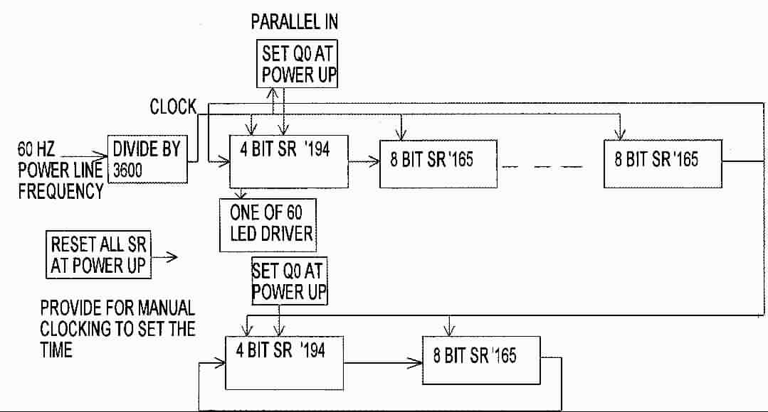

i want to do a normal clock(analog clock, not the digital clock) using LED, who know how to do or who got this circuit?
First, you need 60 LEDs in a circle to mark the minutes. I would use 48 red ones and 12 yellow to mark the 5 minutes. Inside of that circle (or outside) 12 LEDs to mark the hours. The power line frequency divided by 3600 will provide a pulse every minute which can clock a one 0f 10 decoder. You will need 6 of them for 60 minutes, and two that are clocked by the output of the minute decoders to mark the hours.
I discovered that my original idea was too complex, shift registers are easier to do. I only posted a partial block diagram because you will not learn much if I do the whole design.
