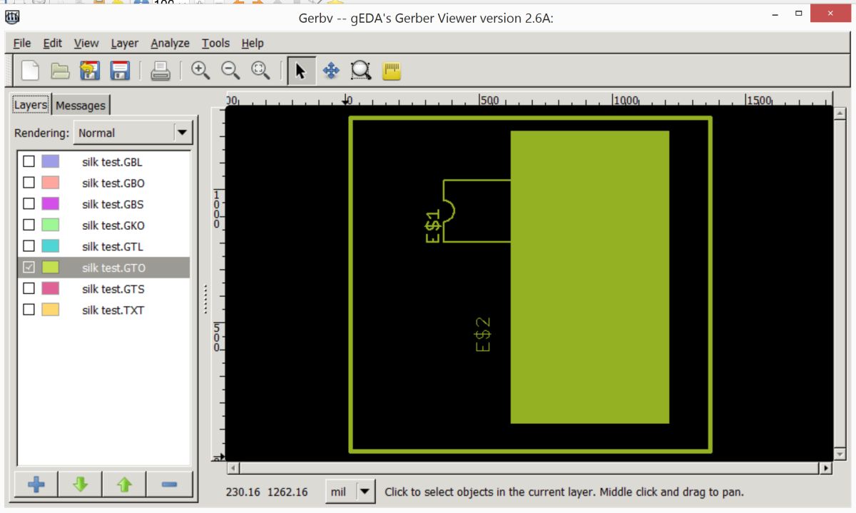

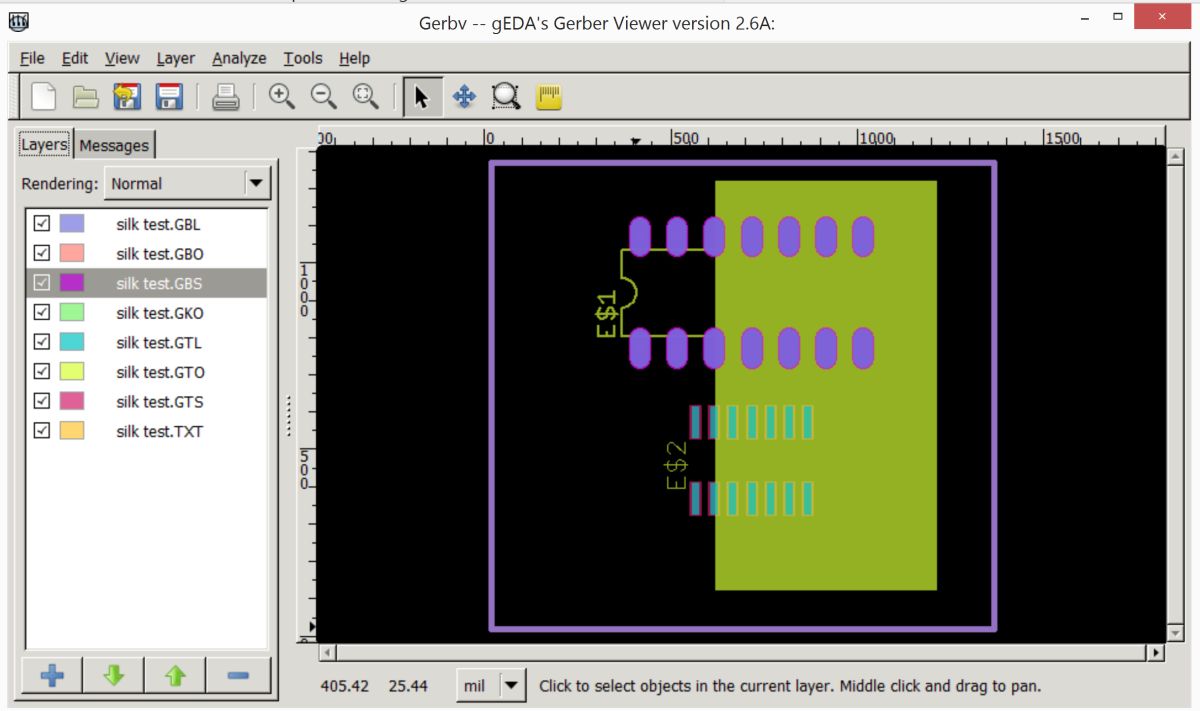

I tested this with Eagle. Created a board with a DIP package and an SMT, half covered by a block of silk screen. I know from previous experience that the silk screen layer will not cover a pad, but I don't know if this was the result of some Eagle did or the fabricator. I ran the CAM file to create the Gerber files and looked at the output.
The first picture includes all the Gerber layers. The green rectangle is the soldermask area on the top of the board.
The second layer shows only the soldermask rectangle. Eagle does nothing to account for the areas where the silkscreen overlaps mounting pads.
Therefore, the fabricator's software handles the overlaps. I think your Dipstrace error isn't so much as error as a warning that your silkscreen layer is going to have holes in it.
