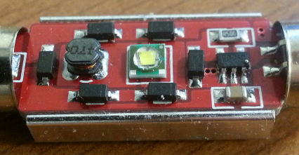

Well looking closer at the module, I'm wondering if maybe it has a buck (or buck/boost?) converter built-in. Can someone confirm whether this is the case? If so, how resilient do you figure it will be in an automotive installation? I'd like it to last for years -- ideally the life of the truck -- which is why I was looking at filtering the input, so there'd be less work for the onboard electronics to do (and thus less heat generated and a longer lifespan).
The coil has "470" on it
the six small black bits (diodes?) have a vertical line marking followed by "S4"
the resistor above the IC-type thing says "R500" (500Ω resistor?)
the IC itself looks like it says "EQC3G"
4 of the diodes are so that the lamp works either way round in the fitting.
It looks like a buck regulator that controls the current in the LED. The inductor is almost certainly 47 μH. The resistor is 0.5 Ω and will be the current sense resistor. I guess the IC is a dedicated LED driver.
