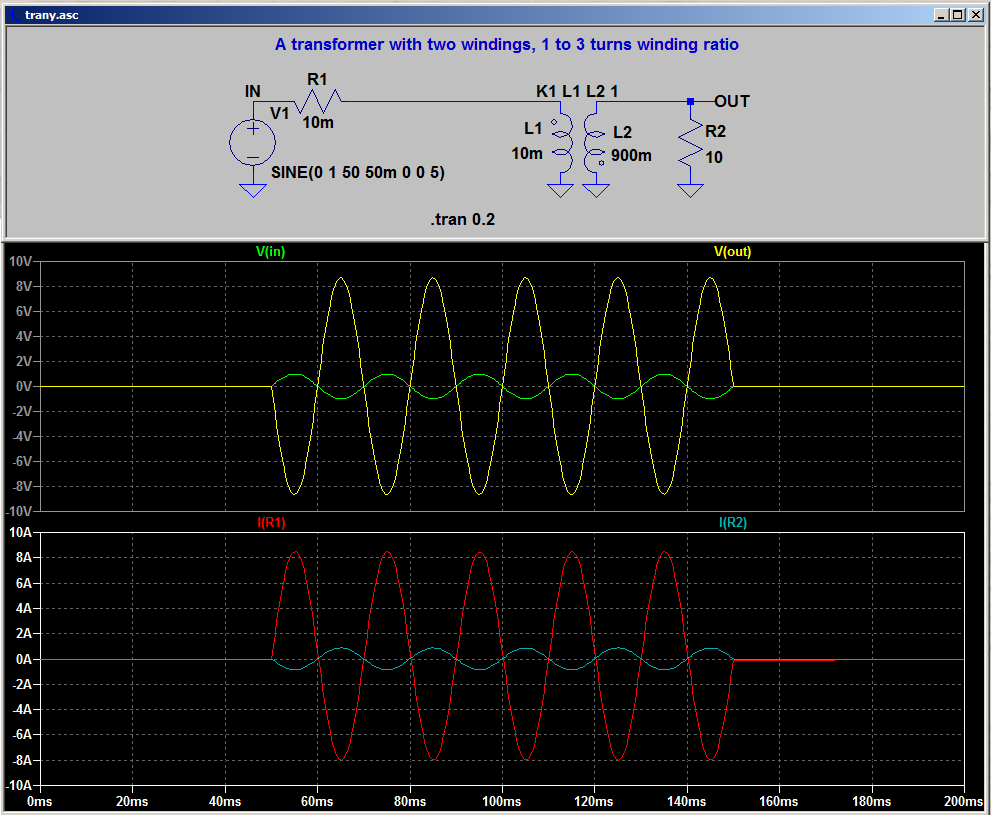

Providing the transformer core doesn't saturate, the secondary waveform should resemble the primary waveform. The secondary voltage will depend on the turns ratio, any transformer losses, and on the magnetic coupling between the primary and secondary. Varying the relative orientation of the primary and secondary is likely to have a major effect on the magnetic coupling.
Running sim:
  • trany.asc
