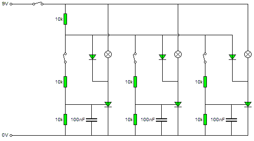

Here's a simpler circuit.
It's designed for three contestans but can easilly be expanded to four.

Thanks! I think i'll go with the Game Circuits one - it seems the simplest to put together in a short timeframe.
Just a small question. Hero, what are those 100nF capacitors for?
Zepher,
Heed the warning in the instructions to not use "sensitive gate" SCRs. The gate resistors and capacitors in Hero's circuit are to prevent false triggering.
Ken
They provide RF filtering.
If the switch leads are very long they can pick up electromagnetic radiation which can cause false triggering. The capacitors short circuit all AC picked up by the switches to 0V.
The simpler circuit doesn't have them, but they can be added if you're haicing problems with false triggering.

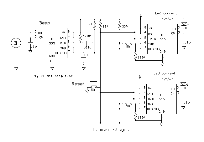

That is because the gate of the triggered SCR has voltage on it. Pushing two switches (triggered SCR being one) may trigger the second SCR. Here is an expandable 555 based solution.

I think this the classic problem of trying to use a "sensitive gate" SCR here. Thus the warning on the web site. The Igt is 1-200uA for CRO2AM. The ones I've used are S401E, that have an Igt of 1-30mA.
Ken
Hm - I could've sworn I saw 0.3A, or is that the maximum current it allows?
Which field of the table shows 300uA?
Adding a low value resistor (start with a few hundred ohms) from the zener output to ground will lower the sensitivity.
