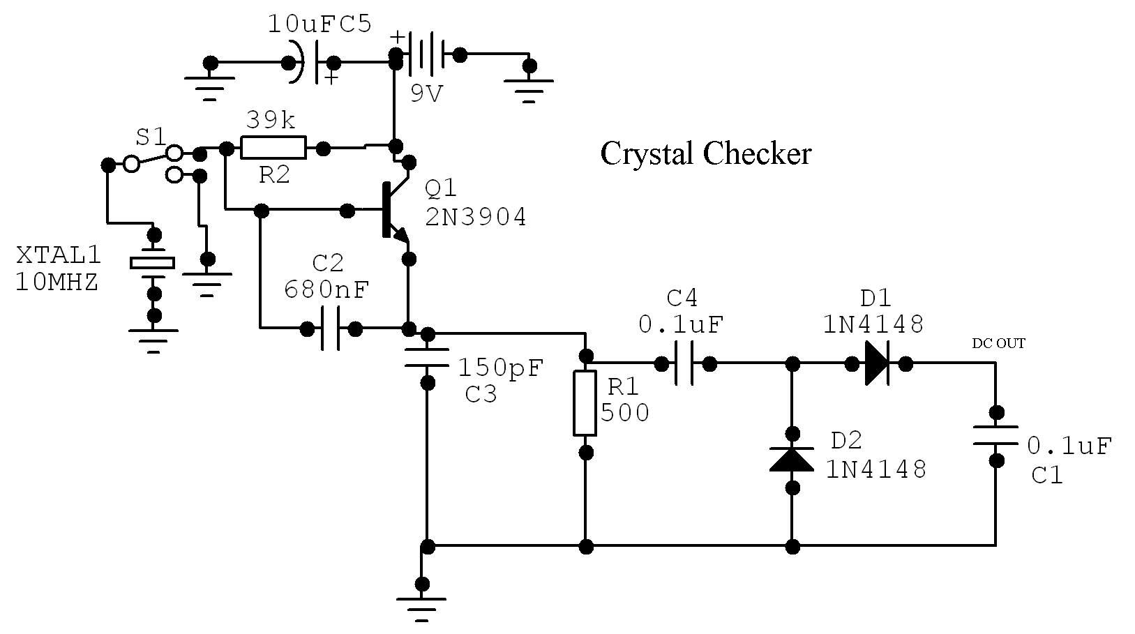

I have a working crystal checker and have entered the circuit in to CM.
The DC analysis is working.
The AC analysis asks for a source.
I can't find a way to tell the program that the crystal is the source.
I just started with the program today.
I'm unhappy with some of the values of the components and also
want to add a buffer circuit at the emitter so as to have an AC out & DC out.
At 'DC Out' I have an LED with no series resistor. None seems to be required.
The switch is only for the simulation circuit.
View attachment crystalchecker NET.txt
What do you want to examine with the AC analysis? AC analysis is for determining the AC transfer characteristics of a circuit. If that's what you want, you can add an AC voltage source in series with the crystal.
If you want to see the circuit oscillate, then you need to use the Transient Analysis, not AC analysis. But note that it can be difficult to see oscillation in a simulation due to the high Q of a crystal and lack of normal circuit noise to start the oscillation. Sometimes placing an AC source in series with the crystal and having it generate a single short pulse at the start of the simulation can help start the oscillations.
An LED with no series resistor is a very low impedance and will tend to short the output.

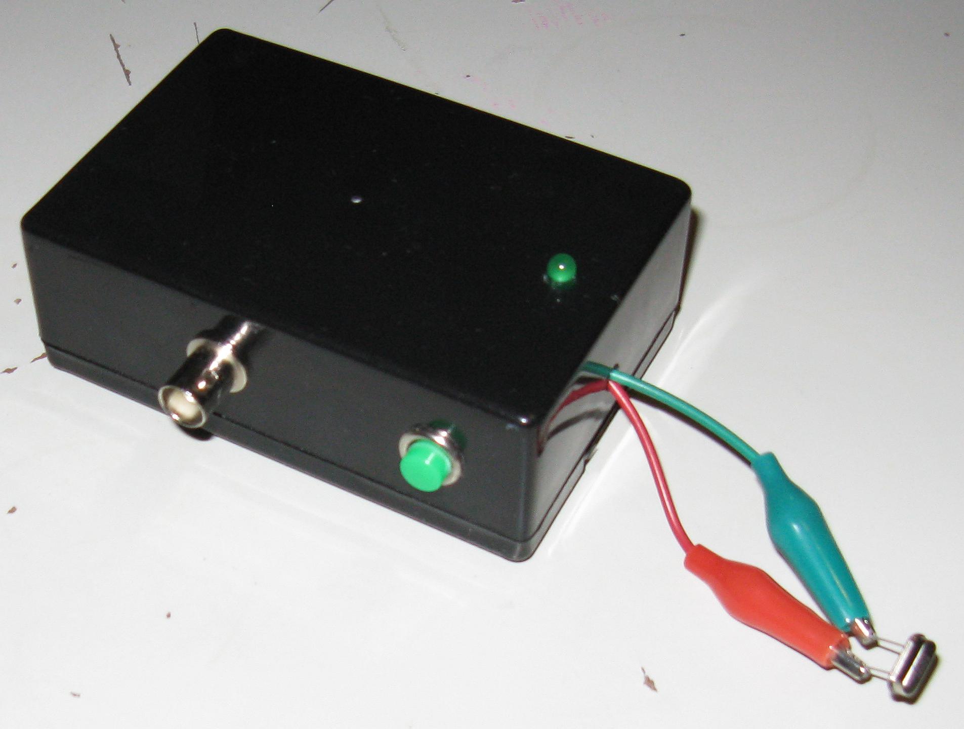

For frequency checking I plan to add a buffer perhaps just acting as a digital switch for interfacing to a scope/counter.
At present I'm sending the emitter directly to the BNC connector. Bad form, I know.

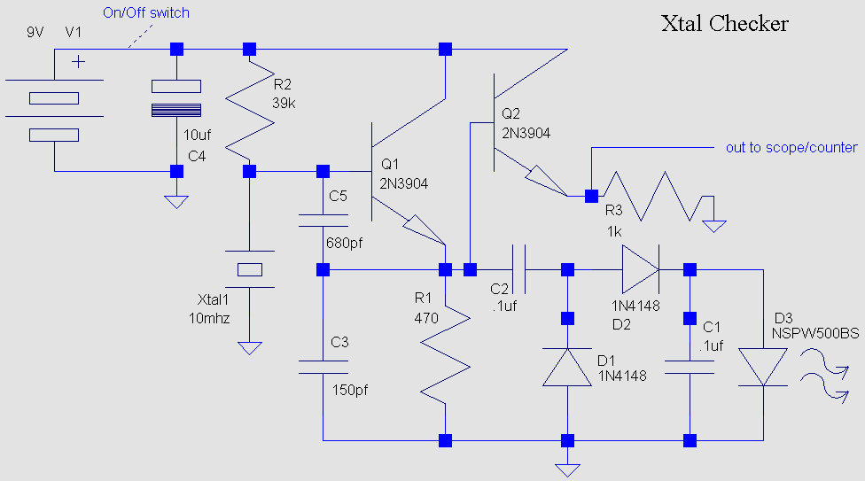

Edit: Finale circuit drawn using LTspice. Is there a way to change how components are drawn? Transistors are so BIG. Resistors are ugly too.

Added an AC source of .25vac in series with the xtal.
The label says .25vac but the icon of the part shows + & - which confuses me.
Still get a 'no source specified' error.
Spics data says: %D %1 %2 %V

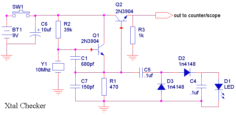

LTSpice capture does not look nice either. Why the big transistors & resistors?
Orcad looks the best.

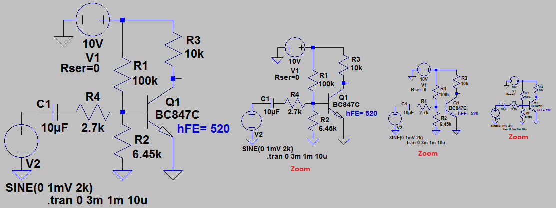

In LTspice a right click on the schematic allows you to zoom up or down and to fit a little schematic on the page to be huge.
