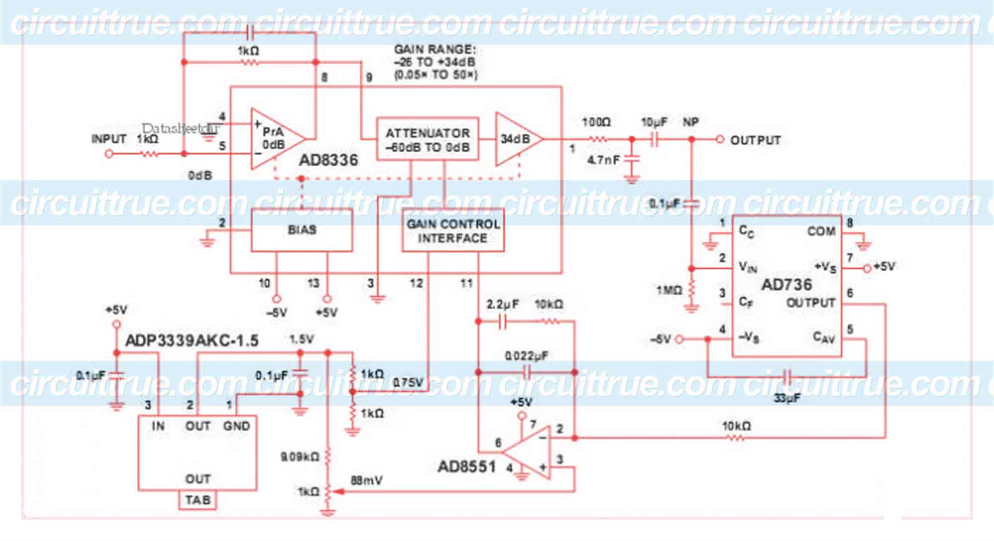

Hi there
I'm a complete newbie to LTspice. I have workkes with simulink a bit for circuit simulation but that too was long back.
I ahve this circuit to be simulated in LTspice:
I looked up some tutorials to begin with and when I sat down to work, I realised that the AD8336 is not an available componenet in the LTspice library. Some more search and I came across a .cir file for the AD8336 on the Analog Devices website. So I have managed to create a symbol for the same in the component libraray of LTspice under Auto-generated.
But it doesn't look similar to the one in the circuit or may be I'm not able to interpret it correctly. How do I go about the simulation and adding the components not available alraedy. I'm not even sure if I'm going in the right direction up till now.
If anyone could please help me with this, I shall be highly grateful.
Thanks :)
P.S: I have attached an image of the circuit I need to simulate.
Also, I was trying to attach the .cir file, But it says not an allowed extension for uplad. So, I'm pasting the contents of the .cir file here:

The link in line 4 of your post is broken.
Welcome to ETO!
There is something about the aeng model that causes LTSpice to have Syntax Errors. It seems to be the ".uselim" that appears in all of these tablulated voltage sources:
E_U4_E8 VPBUF 0 TABLE { V(VPOS, 0) }
+ ( (0,0)(2.8,0)(3.0,1.6)(5,3.6)(12,10.6)(15,13.6))·uselim
I made the symbol for you with the right pin order. I am attaching four files. If you place them a new subdirectory, you might be able to figure out what the "uselim" thing is all about?

Hi
The spice file has some odd statements in it...uselim, np, nonzero.
I had a file I downloaded quite some time ago that didn't have them.
I edited the new file to remove the statements (they were the only differences)
Hi MikeMI
Thanks for your editing. I saw the file.If you could please brief me up in a step wise manner as how to go about simulating the circuit I have shared in my previous post. I shall be really grateful. I have absolutely no knowledge of it. Awaiting your reply
P.S : Thanks to everyone who cared to reply to my post. Any inputs are welcome. I really need to do this simulation. Thanks a lot! :)

That model was developed for some other version of SPice; not LTSpice, and contains statements that LTSpice doesn't understand. You will have to contact an applications engineer at Analog to see if you can get some info about how to make it work...

If you are prepared to accept a simplified model of the 8336, you could replace the VGA part with a single Behavioral Voltage source and use a conventional opamp model for the preamp part.

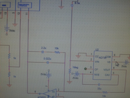

Hi Everyone :)
I know I have not been very active on this thread. Was just trying out things to simulate the circuit.
And so far so good. I have been able to draw the schematic in Pspice using the .cir model file available for download online.
There is a small help that I need. In the circuit that I have shared above, if you look at the pin 3 of AD736, it is open (not connected)
When I do the same in the schematic and try running the simulation, it shows up an error at that particular point (which is obvious).
I tried connecting the pin 3 to No connection but even that doesn't help. How should I configure that pin as leaving it open gives an error.
Please help me solve this problem. I think it should work once this gets sorted.
P.S: I'm attaching a partial image of the schematic I created in Pspice for your reference.
I shall be highly grateful to you guys. Thanks a lot! :)

Try a 10uF cap connected as per Fig 18 of the datasheet.
Hi MaxHeadRoom78
I'm not sure how the pase correction low pass capacitor would help. The image of the circuit I want to simulate has been attached in my first post as agc_ckt. If you could please have a look, that would probably give you some idea of wha its like.
Hi Alec
Thanks for your reply. Are you talking about the datasheet of AD736?
I will look it up surely.
The 10 uF capacitor is basically at pin 3 connected to where?
Read the AD736 datasheet, and see post #13.
Hi Alec
Thanks for your suggestion. I have included the 10uF capacitor as shown in the AD736 datasheet. Thanks to you as well MaxHeadRoom78.
Now when I try to simulate this circuit, it says there is a warning and prompts me to check the log. I'm not sure as to where I'm going wrong, but I believe it could be at the input of the circuit.
I'm attaching a screen shot of the warning error it shows and also the complete schematic I made. Could you please check and help me with the rectification.
Thanks a ton :)
Kindly look through my first post to find the exact circuit I'm trying to simulate.
P.S: Any help from any of the members is most welcome
