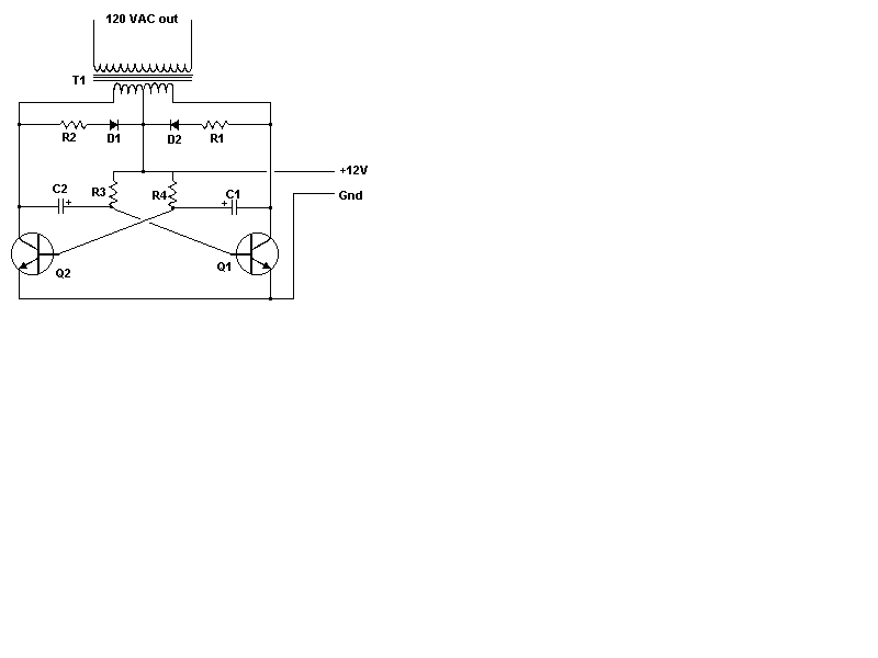

hi,i want to build the circuit below and i want it to oscillate at 50hz would someone please tell me what values i would need for r3 r4 c1 and c2 thanks for any help.

Presumably you already have the values for 60Hz?.
You need to make the capcitors slightly larger - but the tolerances on electrolytics are so large (usually -50% +100%), that there's no way to calculate anything!.
You should also be aware that these crude inverter circuits don't work well (if they work at all?) - the least of your problems is likely to be the frequency!.
dont have values for 60hz either.i was gonna use tantilum capacitors any ideas of the values for the diagram in my previous post or how i could work it out,i just want to build this circuit for experiance.thanks

Watch out for the ratings of store-bought inverters. Their rating is usually for the peak power output for a few minutes. Their continuous power ratings are half.
The inverter you were thinking about building has its capacitors backwards and even if their polarity is correct, they blow-up due to the transistors breaking down and driving huge currents through them.
The circuit isn't an inverter, it's a smoke generator. :lol:

I will have to agree with audio on this one, because you are trying to provide output in an unusual way. Please understand that if you turn on a circuit, and the output isn't done properly, or the components are underrated (less rating than what they should be), the circuit blows up, and therefore, you have generated smoke, should the input be 120V! :shock:

mstechca, do you know what an inverter is? its input is 12VDC and its output is 120VAC at 50Hz, thus the oscillator. Although, in reality, as audioguru has said, its output would instead just be smoke :lol:
