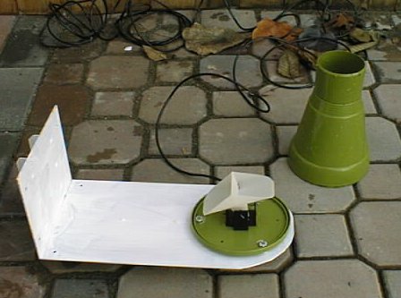

They're called rain tippers
Ask and you shall find.

On the informative side the rain guage is a 0.1 inch per dump type, uses a reed switch and magnet.
That's cool, seems simple to make. A little plastic teeter-totter for rain. And a really nice use for a 1 wire sensor.

What would be the opening diameter at the top?
The larger the funnel opening the more sensitive it is, so you can make it as big as you like - calibrate it by pouring a known amount of water down the funnel (slowly!).

Example if you collected rain with a funnel you would collect scads of it compared to a smaller opening. The tipper in the picture has a tapered opening smaller at the top than the base.

I'm sure you could calculate an equation?, you need to know the accurate level the tipper tips at, and the surface area of the funnel opening - just basic maths!.
No it doesn't, it's not clear from the picture, but the top part is a funnel, with the narrow end at the centre of the 'tipper', the part that goes wider at the bottom is just a housing (it's wider to clear the tipper).

They built one in a VERY old issue of Practical Electronics (now EPE), apparently the biggest problem is surface tension stopping the water tipping out correctly - but presumably the plastic tipper shown is probably better?, the Pratical Electonics article used a metal tipper soldered together.
BTW, the article fed a mechanical counter, it was probably pre-logic IC's!.
