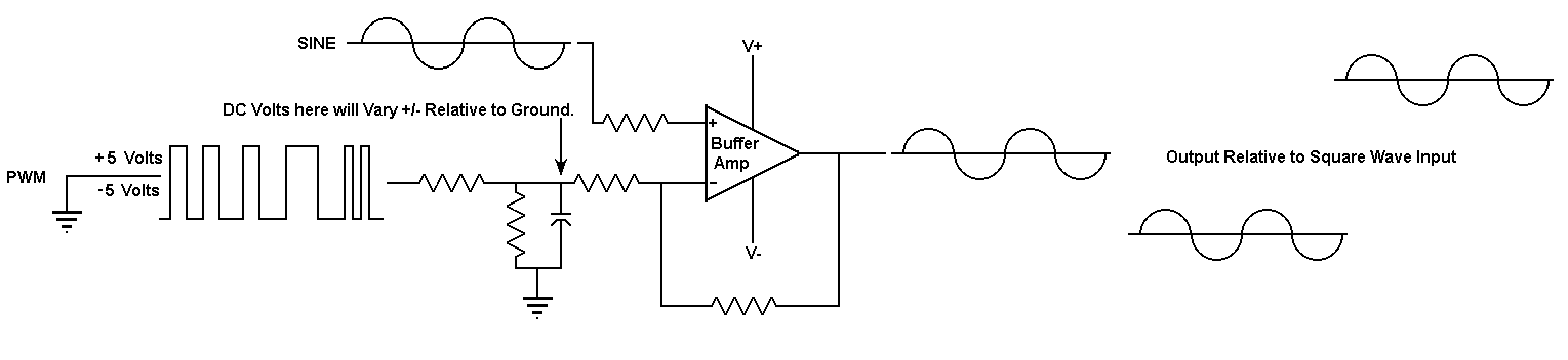

circuit desgn need help. volt bias to sine wave
If you make a circuit like this, it should do what you want

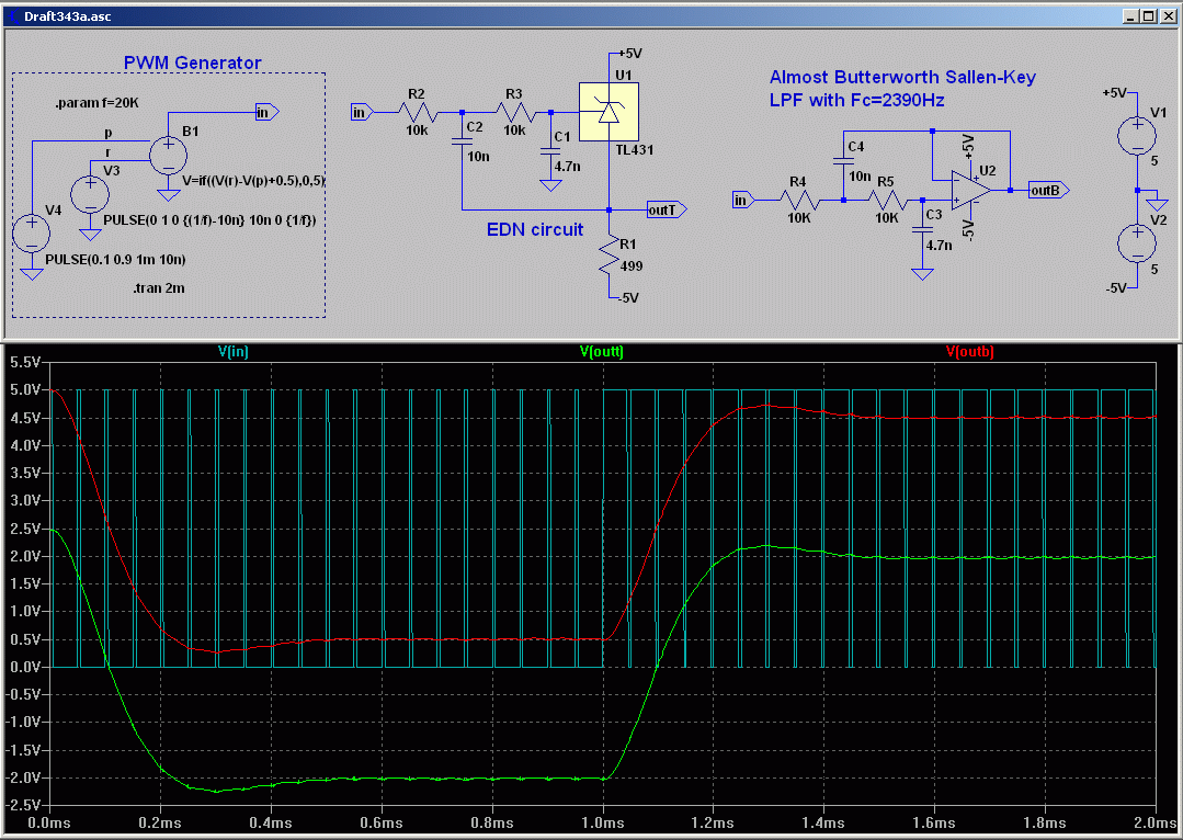

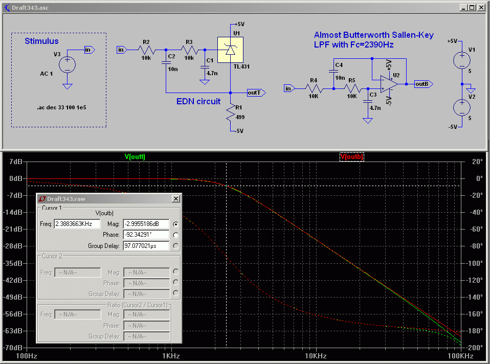

Here is the Bode plot of the EDN circuit compared to a conventional opamp Low Pass Filter. Note that it is almost a 2nd-order Butterworth response with a cutoff frequency of 2388Hz.
In order to properly filter PWM, the frequency of the PWM would have to be at least 10X the filter cutoff freq. Here is the time-domain response of the two filters to 20Khz PWM that suddenly switches from 10% duty-cycle to 90% duty-cycle at 1ms. Note the settling time, the residual 20KHz ripple, and the -2.5V DC offset intrinsic in the EDN circuit.

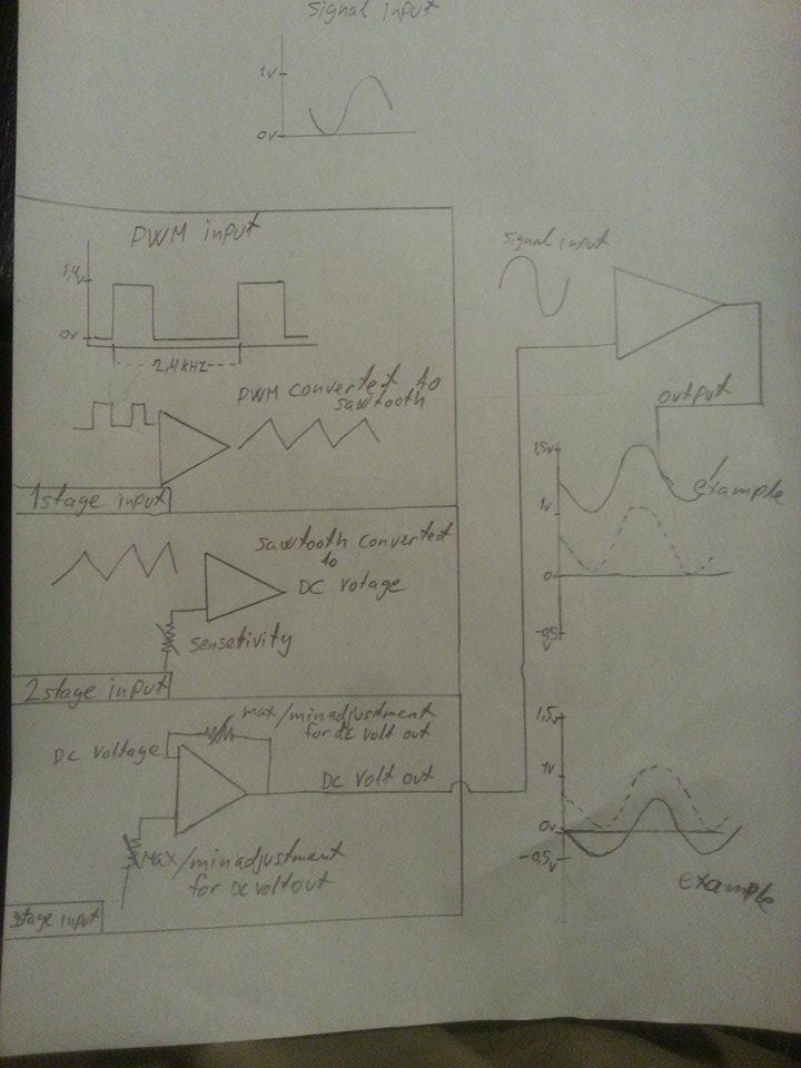

my sinewave output should only variyng between -0,5v and +1,5v after summing dc voltage with the input sinewave
so the dc voltage should vary only +500mv to -500mv to shift the sinewave at the summing stage, it would make the fall and rise time shorter?
my PWM frequency is fixed at 2,4khz
maybe i dont have a PWM signal?
it is a fixed frequency at 2,4khz and the pulse length is warying
maybe it will make a difference?

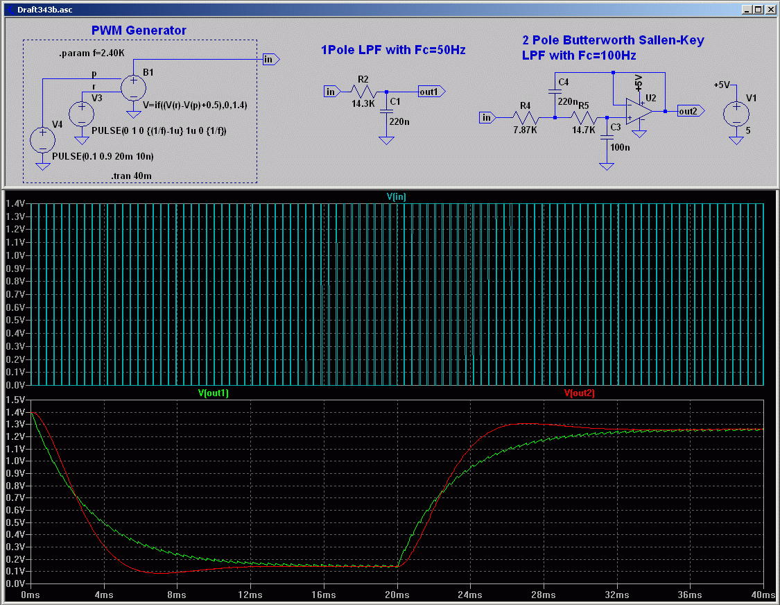

Here is what it takes to convert your PWM signal to a smoothed offset voltage: You have to solve this part of the problem first, before worrying about offseting the Sine Wave.
I generate a 1.4V 2400Hz PWM signal that switches from 10% duty cycle to 90% duty cycle at 20ms in the simulation. You would expect a filter to convert the PWM signal into a DC level which is proportional to the duty cycle. 10% of 1.4V = 0.14V and 90% of 1.4V = 1.26V. I show what happens if you use two different types of filters; the first a simple 1-pole Low Pass Filter with a cutoff freq of 50Hz (~0.02 of the PWM freq) and a 2-pole Sallen Key Butterworth active LP filter with a cutoff of 100Hz using an opamp. Note the improved rise time of the active filter and the reduction in feed-through of the 2.4kHz PWM carrier frequency.
The upper pane shows the PWM signal, changing duty cycle at time=20ms. The lower pane shows the response of the 2 low-pass filters. Obviously, the active filter does a better job of converting the PWM to a varying offset voltage...

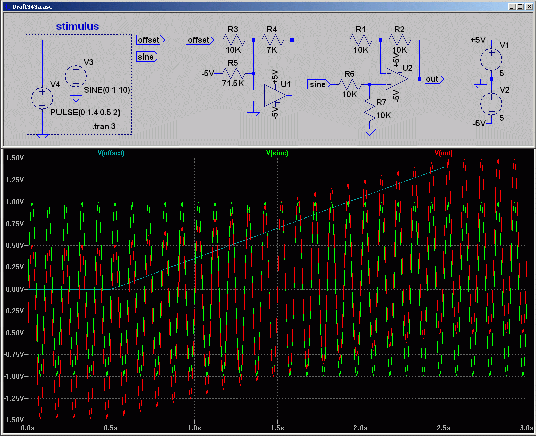

Assuming you have a signal that ranges from 0V (0% duty-cycle of a 1.4V PWM) to 1.4V (100% duty-cycle of a 1.4V PWM), here is a circuit that offsets a 1Vpp Sine wave +- 500mV.
V(offset) lite blue trace represents the smoothed PWM I showed in post #25; ranges from 0V to 1.4V.
V(sine) green trace represents the reference Sine wave, in this example, 10Hz.
V(out) red trace is the Sine Wave offset by +-500mV, as a function of the smoothed PWM.
To make the effect of the offset variable, replace R4 with a 20K pot wired as a rehostat. This will make V(offset) produce shifts of the Sine wave that are bigger than +-500mV or smaller than +- 500mV, but still centered such that no shift occurs when the PWM is 50%, i.e. V(offset) = 0.7V.
If the amplitude of V3 is externally variable, you can eliminate the voltage divider R6/R7. If V3 is fixed amplitude, you can vary just the Sine amplitude at V(out) without affecting the shift by replacing R6/R7 with a 20K pot.

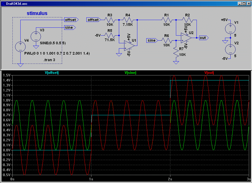

great work but will it work with my positive signals sine: +0v to +1v pwm +0v to +1,4
Yes. Here it is again, this time with a 1Vpp Sine centered on 0.5V. I slightly modified R4 to get closer to +-500mV shift. I also show the shift for three values of the smoothed PWM V(offset): 0V (0% duty-cycle), 0.7V (50% duty-cycle), and 1.4V (100% duty-cycle).

V3 amplitude is externally variable yes and the sine output need to be the same amplitude as the input.
im not understanding the first point too well. Is the 0% and 100% offset adjustable by 2 different pots?
i mean the 0% offset shold be adjustable by pot from -500mv to +500mv (not critical values but in that naberhood)
The same for 100% offset shold be adjustable by pot from -500mv to +500mv

No. The shifting of the Sine wave by +- 500mV is directly controlled by changing the PWM duty cycle from 0% to 100%. Hence you need the low pass filter of post #25 to convert the PWM signal to V(offset), which is shown in the simulation of post #29 as V4.

I told you in post #27. Here it is again:
The bottom line: Varying R4 with a pot shifts the center of the Sine Wave up and down. Varying R6/R7 with a pot changes the peak-to-peak amplitude of the Sine Wave.
