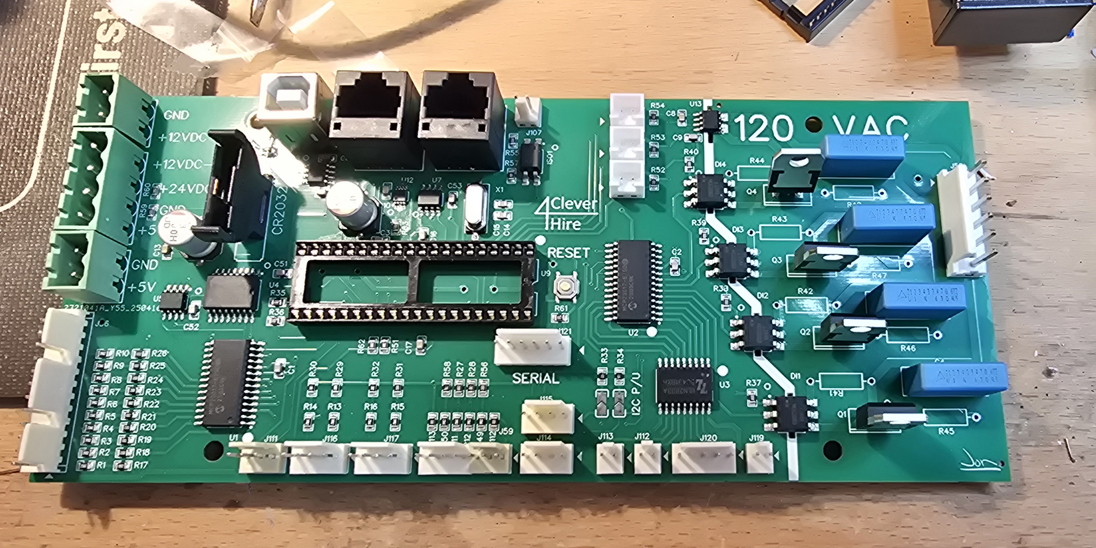

The picture shows the vending machine control board I'm just finishing up. You may notice an abundance of 0.1" pitch KK type headers i have a couple tips to help get 0.1" pitch headers nicely installed.

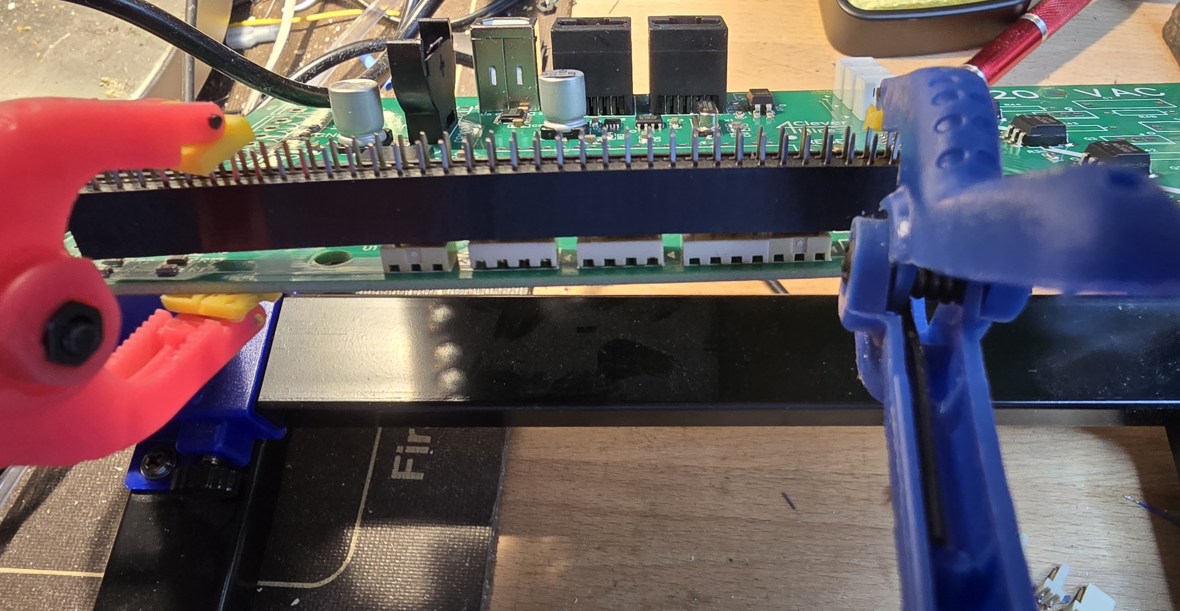

The second tip is to space header connectors on a grid according to the pitch of the headers, leaving an empty position between connectors. This leave room for the mating connectors. In the context of this discussion, it allows you to bridge all of the connectors with a female header strip, aligning the connectors. Add a couple of spring clamps and the connectors are held in position while you get them soldered in place.

A better way to assure that the pins are nicely aligned across the row is to use your second tip: Using the strip socket as a carrier, load all of the connectors into the socket, then install the entire row on the board as a single component, solder everything, and remove the strip socket.

Attached is an image of a recent board. (The extension is to accomodate a 9-pin FFC cable from a keyboard.)

Well, maybe so, but the most useful thing to me for my programming connector is some key, so I can't plug it in backwards. You never know what your mental state will be when you finally have a solution to try. Thus, for ICSP (Microchip), which requires 5 pins, I use a 6-pin connector and blank the 6th pin, so it can't be plugged in backwards. The upper left header in the board I show has that.
