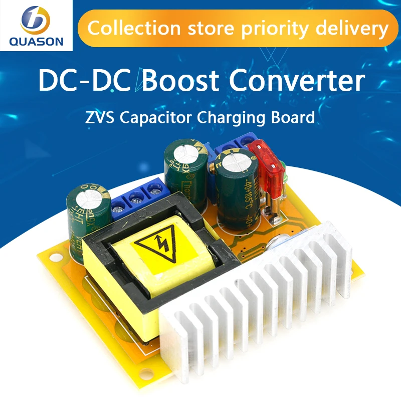

What circuit would you recommend for switching a small high voltage transformer then?
I’m trying to produce steady arcs about a half an inch to an inch gap from parts and a circuit that take up the least amount of space possible.
I don’t see the link you mentioned above
Well damn - lost the link somewhere? :D
It was here:
However, now you've mentioned what you're looking for, try this link:
