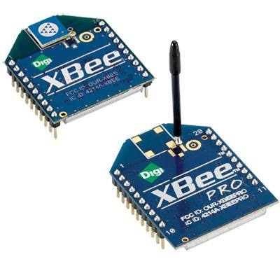

Chip vs Whip antenna... the data sheet for the XBEE module (XBP24-AWI vs XBP24-ACI) don't say if there's a difference (or I was unable to find it)... any comments on chip vs whip .. in terms of "anything" .. (power consumption, range, sensitivity ...) as if the chip antenna is "as good as the whip one" ... I do not see the reason for the whip one :)

I found the following information in this datasheet:

[FONT=Verdana,Verdana]The following antennas have been tested and approved for use with the embedded XBee-PRO RF Module: [/FONT]
[FONT=Verdana,Verdana]• Dipole (2.1 dBi, Omni-directional, Articulated RPSMA, MaxStream part number A24-HABSM) [/FONT]
[FONT=Verdana,Verdana]• Chip Antenna (-1.5 dBi) [/FONT]
[FONT=Verdana,Verdana]• Attached Monopole Whip (1.5 dBi) [/FONT]
[FONT=Verdana,Verdana]The RF modem encasement was designed to accommodate the RPSMA antenna option. [/FONT]
So the chip antenna has a gain of -1.5dBi, and the whip antenna has a gain of +1.5dBi.
What this means is that there is a difference of 3dB beteween them, the whip antenna is superior by a factor of 2 in terms of transmitted and recieved signal power.
[/FONT]
Don't over look the dipole option, with an extra .6dbi isn't too shabby. Making a dipole for it shouldn't be too hard. Out of curiosity what's the directionality of those chip antennas?
Most of them are linearly polarized in the plane of the pcb and working against the large pcb area as a counterpoise, so it would have the typical donut pattern that you might get from a typical monopole, only it is lying on its side and would be horizontally polarized. If you orient the module vertically, then it would come close to matching the pattern of the little whip antenna on the other version.
