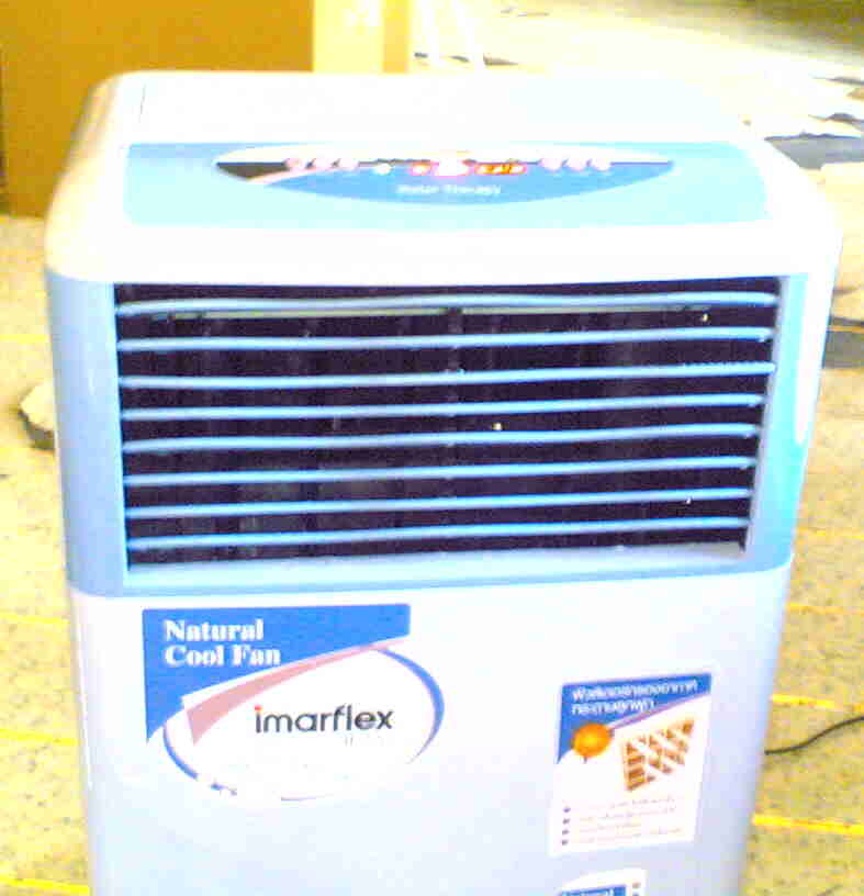

I used an evaparative cooler for my work place in the living room for about four months when it quit working completely two days ago.
I purchased another model (Imarflex IF555) yesterday which looked promising at the store, higher air volume flow at higher air pressure (radial type fan) and large area cooling grid.
Unpacking was the first problem. Opening the carton I encountered the first obstruction. Removing the top foam (shock absorbers) there was no space to get hands to the body of the device. (Size: LXWXH 60X40X100cm, weight without water 15kg).
So I turned the opened box upside down and slipped it off the device.
Removing the bottom shock absorbers was no problem at all. :)
Next I filled the water tank using approximately 10l of rain water and put the device on operation.
The fan started alright (three speed), but no water available for the evaporative part of the cooler.
Removing the back cover and cooling grid I found the reason: a small aquarium pump floating on top of the water. Reason: (turning the device upside down the pressure hose had come lose from the pump, since it was not mounted to the tank bottom at all, except for four rubber adhesive "boots")
That problem was solved quickly and turning on the device again I really got a surprise: The outlet spit pure water all over the living room through the fan.
A 90 degree bend rubber hose at the top water feed outlet looked some kind of displaced to me.
Further investigation proved that it should have been attached from the top tank to the distributor bar, consisting of a plastic pipe with 22 drills distributing water evenly over the entire length of the device.
Now the system works properly, except for the water level indicator. That sweety indicates zero with a full tank. :)
