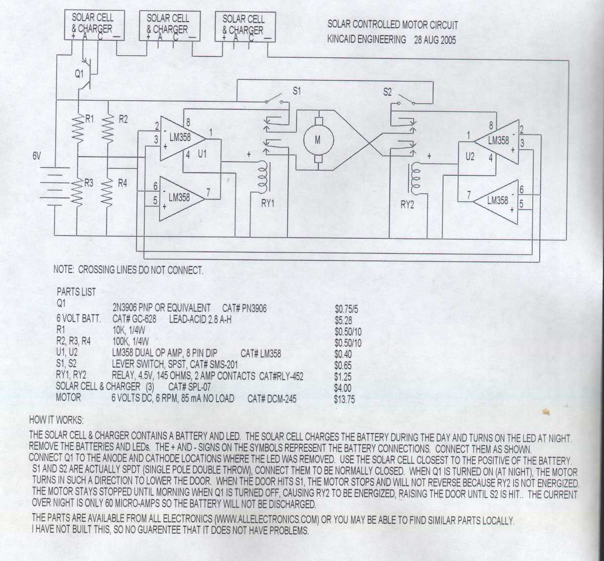

What I would like to do is build a controler to control a DC motor which will raise and lower a vertical sliding door. Ideally, the door control will use a LDR to detect dawn and raise the door. The same LDR will detect when it is dusk and lower the door.
Bonuses to the design would allow a delay between 1-60 minutes between triggering the LDR and actually opening or closing the door as well as a mechanism that would operate like a garage door that would lift the door back up if it encounters an obsticle (like a chicken in the door), wait for a minute or two and then try to lower again. I'm not too worried about the last point though as I'll make sure that the door is light enough and moves slow enough that it won't hurt the chickens.

I looked for a supplier in your location, but did not find any. These parts can be ordered from All Electronics. Schematic and explaination attached.

Wow. Thanks for the diagram. I can follow how this works but just have a quick question about S1 and S2.
I assume that using these as limit switches I will need to rig the door up so that when it closes if will come to press down on the S1 lever which will open the switch and stop the door. Then in the morning when the motor reverses and lifts the door, the door lets S1 revert back to a closed position and similarly that when the door raises it will press S2 to an open position and then when it decends it will allow S2 to revert back to a closed position?
If this is how the switches work then while the door is moving between the fully open and fully closed positions (before hitting the limit switches in each direction) both S1 and S2 will be in a closed position?
The beauty of this design is also that it looks like the solar cells will slowly trickle charge the battery during the day. This means that the battery should last for ages without having to be replaced or recharged.

Russlk said:
You are right, but when both switches are closed, only one relay is energized.

A couple of modifications that I have thought of for the design are a basic master switch on one side of the battery to allow me to turn off the door for maintenance or manual operation or things of that nature.
The other thing that I would like to do is incorporate a delay timer into the night side of the circuit. I have read a bit on 555 timers. Is this something that a 555 timer would be used for (eg. LM555 TIMER (MC1455))? Would it be terribly hard to incorporate a timer that waited say 1/2 and hour to an hour before the door closed after it got dark. This way the chickens would have plenty of time to get in and they wouldn't be left outside by mistake. The other thing that it could do is prevent unexpected door closures if say a really dark cloud went by as the delay would hopefully be enough for the light to come back and the circuit to reset itself to keep the door open. I'm not worried about the day side of the circuit as it isn't a problem to open the door as soon as there is enough light to trigger the photocell.
I have found a kit for a count-down timer (https://www.electro-tech-online.com/custompdfs/2005/08/ck1611.pdf) that uses a 555 oscillator and 4020 ripple counter to provide a configurable delay, but it is a 12vdc kit and I'm not sure what I might need to modify to make it suitable for the 6vdc door control. The kit controls a relay and I was thinking that maybe the components could be inserted into the door control circuit to control the night side relay instead of the kit relay. I could either build the kit on it's own PCB and then try to wire the two together or I could include the necessary components from that design onto the Perf Board that I build the door control on.
Can you recommend what to do about the voltage of the circuit, where to include the timer circuit in the door control circuit and whether you recommend incorporating the timer circuit into the door control or building the two separately?

UP/DOWN motor control is loosely based on automotive power door controls using two automotive relays. One for up and one for down.
They are arranged such that the DC motor is dynamically braked so the motor stops quickly. The trick is finding a limit switch that can handle the relay current which, I think, is on the order of 200 mA.
If neither or both relays are engaged, motion stops. No power is used by the coils if the door is fully open or fully closed.
