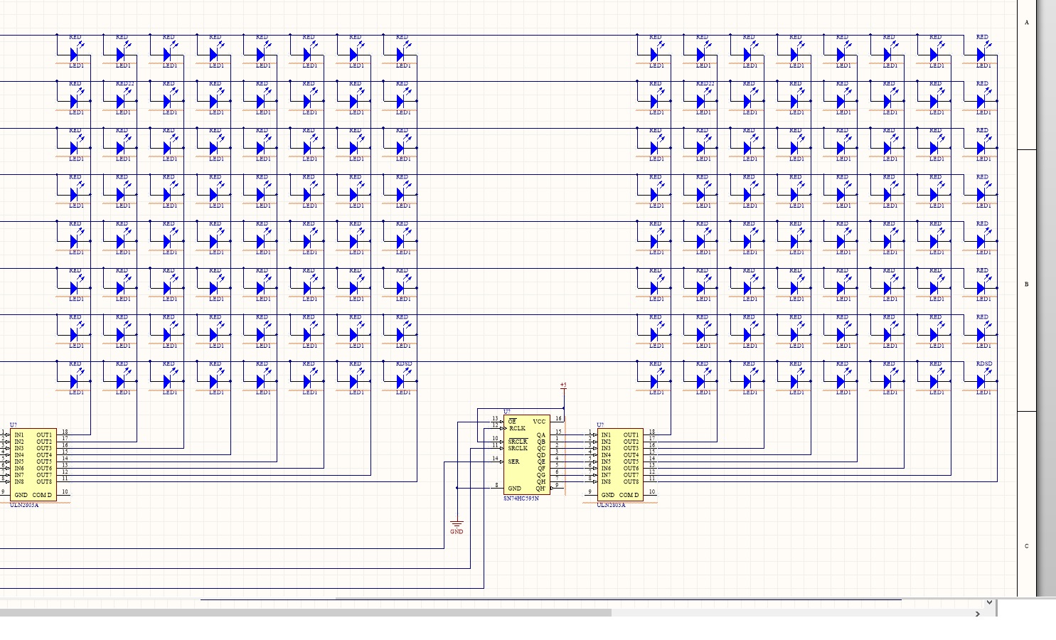

Can someone please check if i have put it all together correctly? I a trying to make PCB from this.
So i ll make 72x8 LED dot matrix display, and i thought of driving row by row. So refresh rate would be 1/8, and because of that i have put resistors to the anodes of rows which are very small value because if all 72LEDs are on, they would pull 0.5A. Doesnt mind those 10K on top of resistors, it is not true (i have calculated R should be 10ohms). Also doesnt mind those mosfets, i only know i have to use 0.5A, NPN transistors or something..
Columns are driven through 74hc595 and uln2803 to ground
On these pictures u will see only 2 8x8 matrices, but it would be 9 8x8
Please tell me if this would work the way i want (and think) it would :)
The shift register wiring looks OK to me. Assuming I didn't screw up the math, it looks like with your current setup you will need ~40 kilohertz shift clock to be able to refresh the entire screen 60 times a second, which is a very modest and easy to do speed. So I would say you have your overall design pretty well figured out.
If I changed anything about what you have now, I would put the resistors on every column, not every row, unless I was really trying to cut cost. Doing it your way puts 72 LED's on one resistor, which could cause you problems with brightness, power, heat production and so forth. Also 500ma transistors are not going to cut it for 72 LED's unless they are very very low power LED's. I would aim for 2 amps per transistor, and I would probably use MOSFET's, not BJT's. If you do the resistors like you have them now, make sure they are large, 5 watt or more units. And make sure they are fairly precise.
Another option is to buffer between columns after each 8 LED section. This would solve both the transistor and resistor problems simultaneously.
Ok, than i will put mosfet with 2A or more :)
And i will put resistors as you said, because you are probably right.

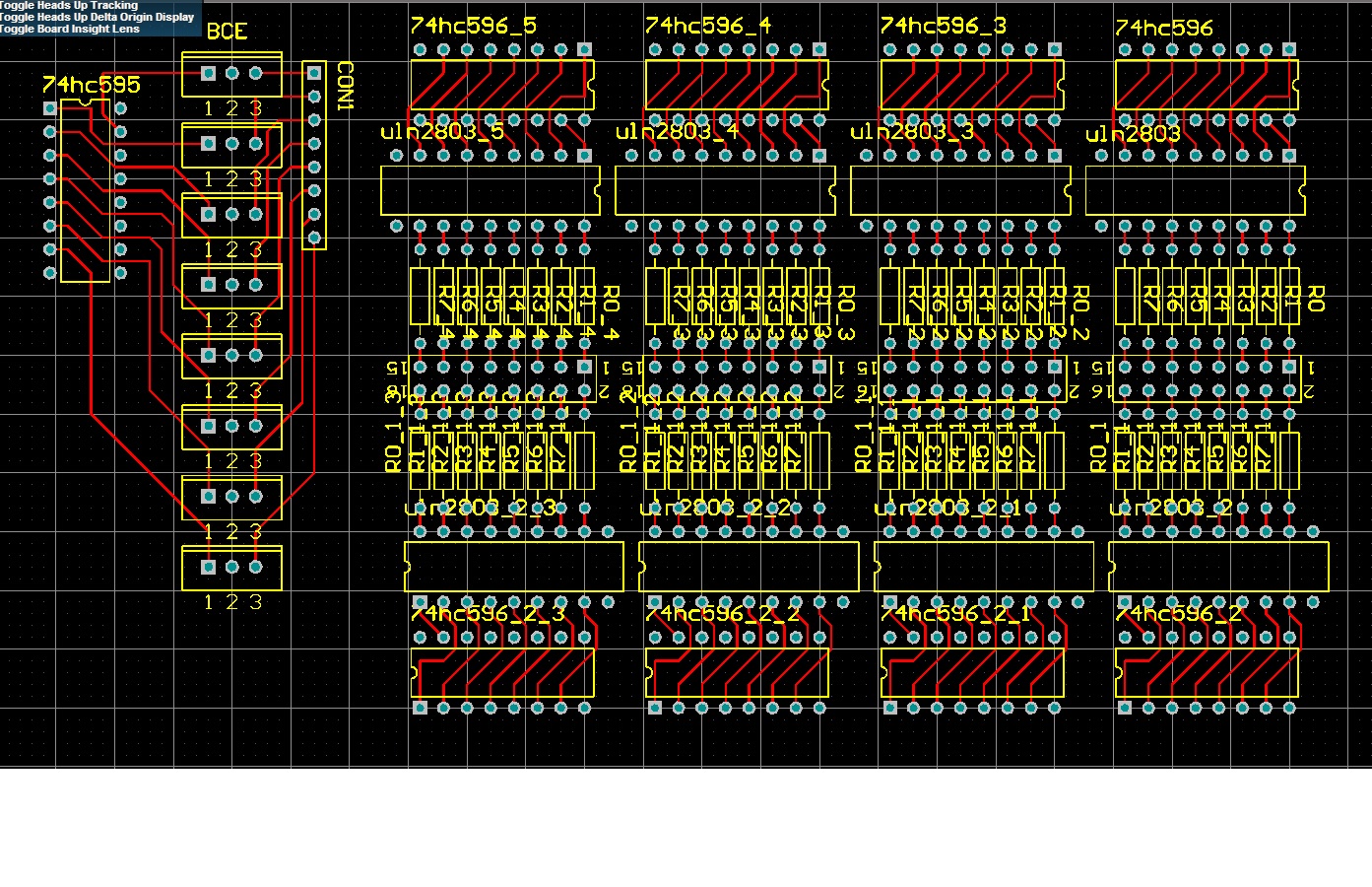

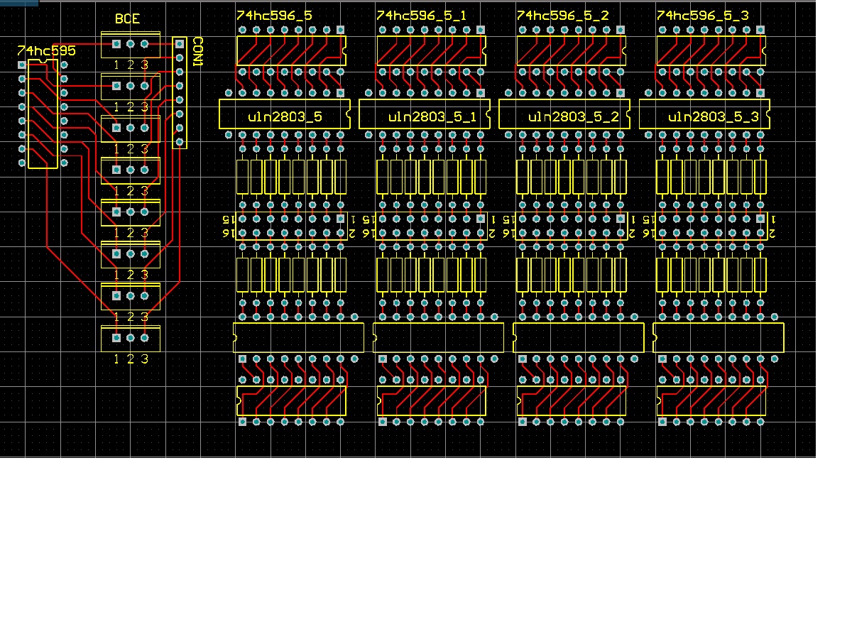

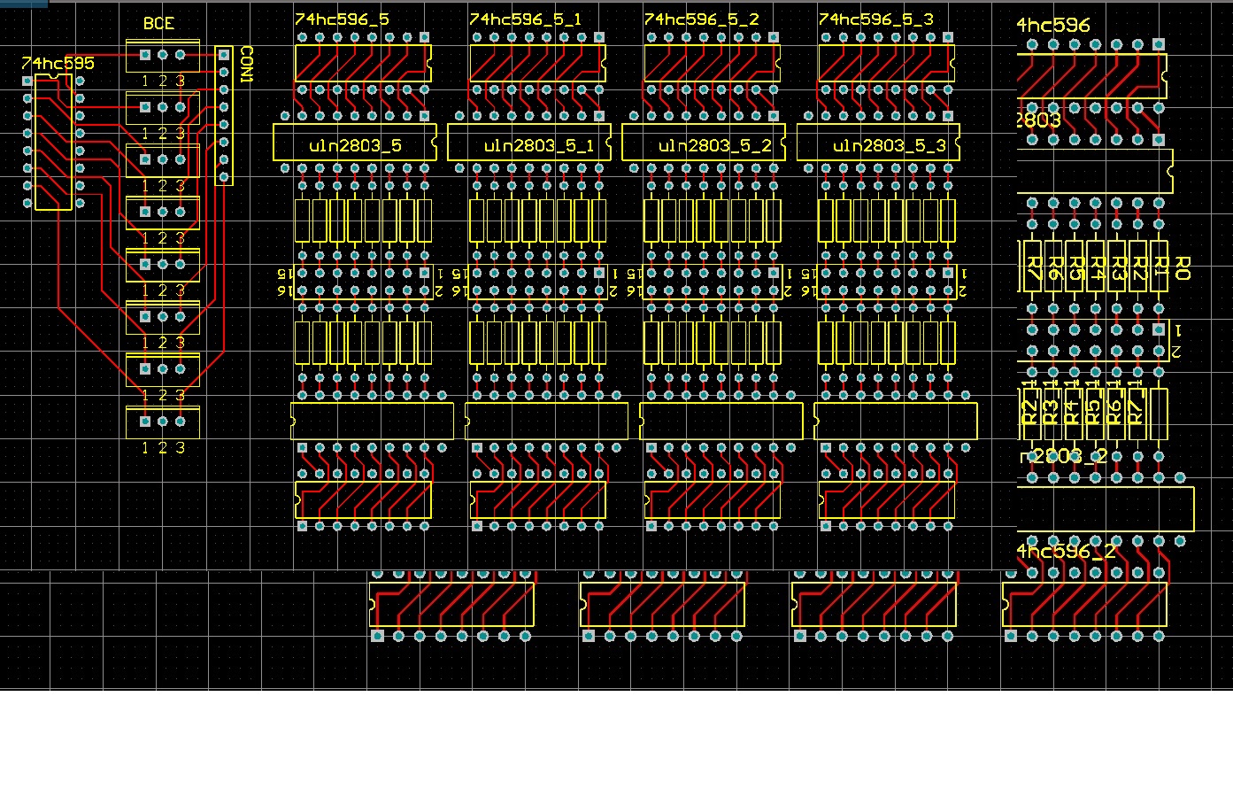

Here is my PCB project for now, some wires are missing for now. It is for 64 columns, i have put 4*16 connectors in the middle of the board (i think that is pretty good idea)..
I will see if i could actually make this board because it would be my first one :)

For high side switching MOSFET's, make sure you are using p-channel MOSFETs and make sure they have logic level gates. Here is a good choice I would think. https://www.digikey.com/product-detail/en/SPP15P10PL H/SPP15P10PL H-ND/2783608
Also note, all of pin 3 should be wired to the same positive supply, and all pin 1's should be wired to the shift register, and all pin 2's go to the rows of LED's. Finally, know that the MOSFETs will invert your signal. Logic 1 on a MOSFET turns it OFF, logic 0 turns it on. So to turn on one row at a time, make sure the last 8 bits you send are all 1's minus the row you are activating.
Hmhmhm. Yea you are right about that, and thank you for your advice, but i drew board for mosfets that have:
PIN1: to shift register (base)
PIN2: to +5V (all of them, source)
PIN3: to rows.
Can you think of one that has that configuration? Just because of wiring.. I am almost done with drawing the board, and tomorow i will make it
They probably do make them like that, but I have never seen them that way. 99.99% of all MOSFETS are in the pin order Gate/Drain/Source.
You are probably SOL on that front, sorry.
Ok then, i have corrected it :)
One more question. I have +5V on the other side of board, do i need it to be more than 10mils? Because of current i mean. All wires are 10mils for now
Probably for some things.
10mil traces on 2oz board can handle a max of ~1.5 amps. Some of the connections, the aggregate power traces mostly, could need more than that. I would say 15~20 mills would be best. PCB fab houses usually charge more for doing boards with thinner traces, as it takes better equipment and testing to do it, and it may require more etchant. So going bigger with the traces may have a price benefit.

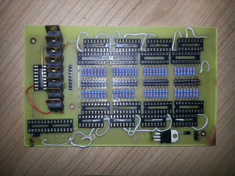

Here is the picture of the back side before i started soldering it
I did the process of making PCB for the first (and second) time. First time it was not good, so i did it for the second time and at that time only 1 wire was broken. I did it with a help from a friend, he know the process and has chemicals and UV-LEDs.
So i have printed my 2 sides of PCB to plaus paper on a laser printer. Then I alligned those papers and put board between them. I put it in the some kind of box with LEDs on upper and lower side of PCB. Lightning was 7.5mins long, and then i put it into 2 chemicals for some time and that was it. Pretty easy i would say. I have just ordered 200 UV leds for myself :)
And, yes, i will turn on and of row by row, so the whole cycle would consist of 8 steps like you said :) I hope it would work
But today i run into a problem. I have completed my board, and i have programmed atmel328P in arduino uno and put it into my board. Just simple LED blink (pin 13). LED DID blink but just a few times. On original arduino this chip works well, led blinks, but on my board it blinks just few seconds, and then it looks like it run out of power. Like some capacitors is "eating" power. I pull current from USB so that is not a problem. Shift registarts dont work either. I dont know why is this (LED running our of power)..

What power supply are you using? You may need something bigger. Try a PC power supply. Use the red and black wires.
Also, something I noticed the other day but forgot to mention, the FET's you are using are not specifically labeled logic level. Logic level FET's are made so they can be activated by things like shift registers and AVR micros. By not being specifically logic level FET's, they could be left slightly turned on and causing a system wide power drain, though this should also show up as all the LED's glowing a little bit. Try pulling the connections for all but one row of the LED's, this should limit any power draw from such things down to a minimum.
Also, did you remember that a logic 1 to a FET turns it off ??? Make sure you are sending ground/logic 0 to only the one you are turning on.
I understand why i should use bigger power supply but usb is not a problem if i am only powering arduino and 1 LED (not in matrix).
Also, i have tested this configuration on breadboard, but without arduino and programming shift registers, i have only put wires on +5V or 0 as logic 0 and 1 and it worked. As shift registar also gives only 5 or 0 i think it would be good.
And about turning on FET.. i wrote 170 which is 10101010 so 4 of them should be ON either way.
But it looks like that something is wrong with arduino connections because led on its pin 13 only blink for few seconds and then power "disapear"..
