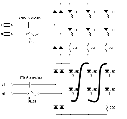

From the link in post #2: Multiple LED:
I know this is not really to the question. But. Why parallel LEDs in a 220V to LED circuit?
When paralleling LEDs you need more current thus a larger capacitor. (which is already very large)
The goal is to get from high voltage to low voltage. So series LEDs make more sense to me.
It would provide some redundancy in the event of failure of one string; though the current in the remaining strings would increase by 50% each.
