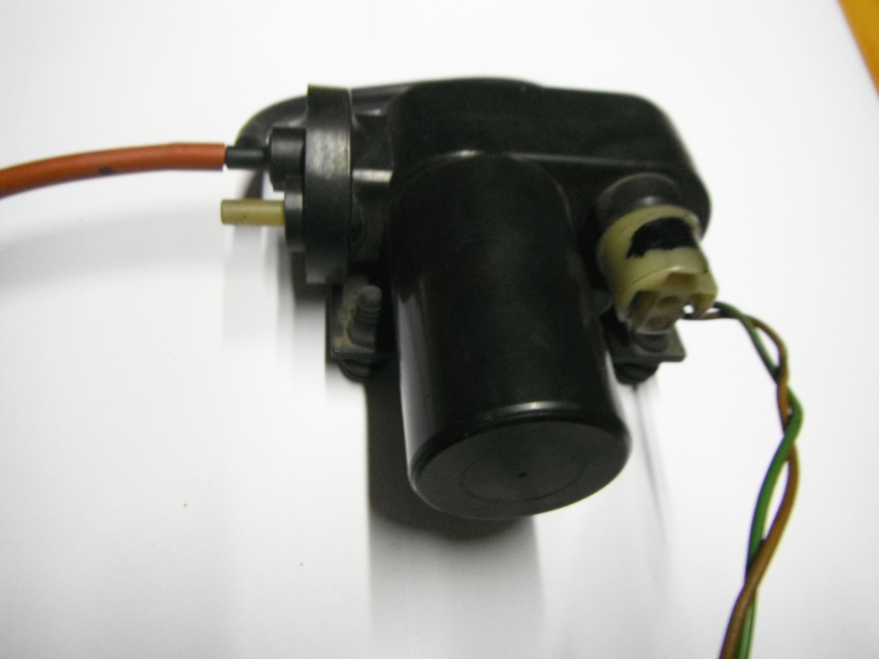

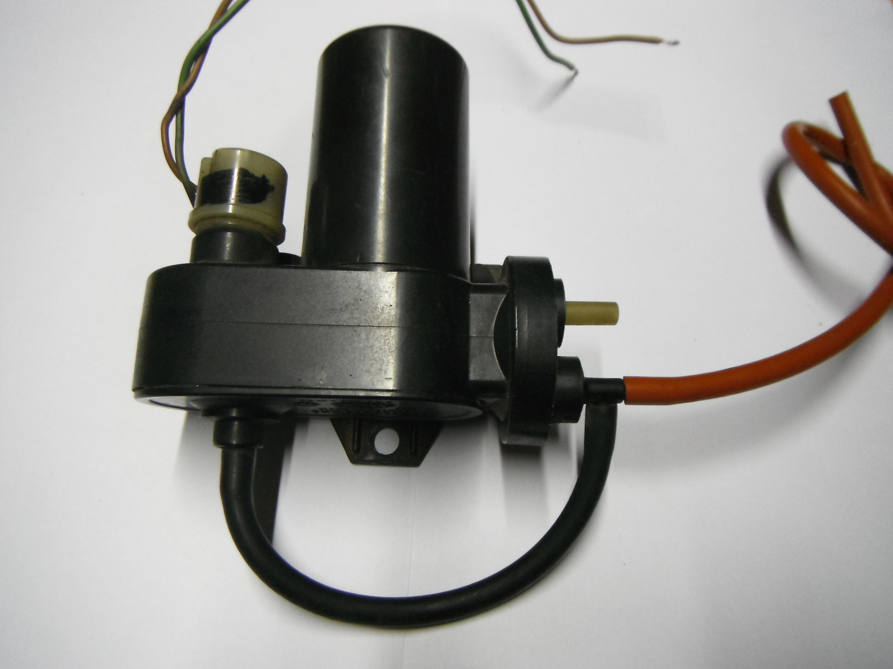

You could use a salvaged 12V vac pump from an 80s BMW. its used to boost the vacuum for the cruise control. This pretty neat as it has a Vac switch that turns it off when it has sufficient vacuum.

Yes! As I heard, many cars from 80's had vacuum pump as "brake assist"! I searched around already, but with no success. Also some "central locking" mechanisms use vacuum (no success with them too).
