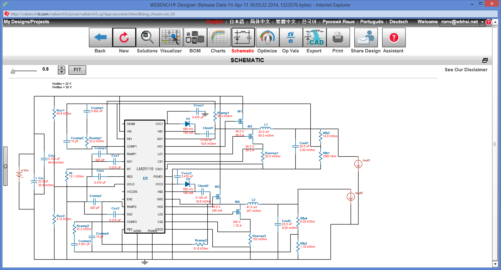

If your handy you could build one like this:
Or you could buy a couple of wall worts for the 5 & 12.
Or give in to Ebay.
Or use a couple of linear regulators with heat sinks, but they might get a little big. (but easy)
