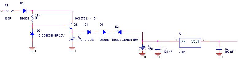

I am trying to make a power supply circuit, which has to supply 5V @ 50mA max, and 15V @ 1 mA max.
I was thinking of using a single phase rectifier with 1 diode, a reasonably sized cap of say 47µF, and behind that for the 15 V part, just a zener and a resistor, and for the 5 V part an 7805.
However, the 7805 can only take 35 V max, and also I do not have any space for large cooling or anything.
Is there a simple and cheap way of limiting the input voltage to my 7805, without having to just dissipate it through a series resistor ?
thx

Isn't there a way of 'shaving' the peaks? I have seen a circuit somewhere where they use some kind of a transistor and a zener diode to clip the peaks. But I do not know what kind of a transistor, the package is too small to read the label from it.
Heat might be a problem in my application, hence I would prefer smaller dissipation...

If I do nothing with these regulators, even with an LM317 and an 7805, I still have to dissipate too much energy, unless I have a large cooling island on the PCB or something, for which I do not have the space.
However, I have seen a circuit (I have reverse engineered an existing product and drew a little schematic of it) which seems to be able to do it all with standard SMD components and the regulator even in an SOT8 package.
I am just not sure how this works, and how much current I could draw from it. The components on it however are really cheap, and it saves me from going to some switching regulator.
Anyone any insights in this?
I don't understand why you haven't just used the LM317.
At 50mA the power dissipation in the LM317 would be about 950W.
The power in the LM7805 would only be 500mW.
If you worried about the LM317 overheating then connect a 1W 180R resistor in series with it so it will only need to dissipate 300mW.
The power still needs to be dissipated somewhere so those zeners will still need to be appropriately rated.
You can alway use a switching regulator which wouldn't need any heatsinking.
