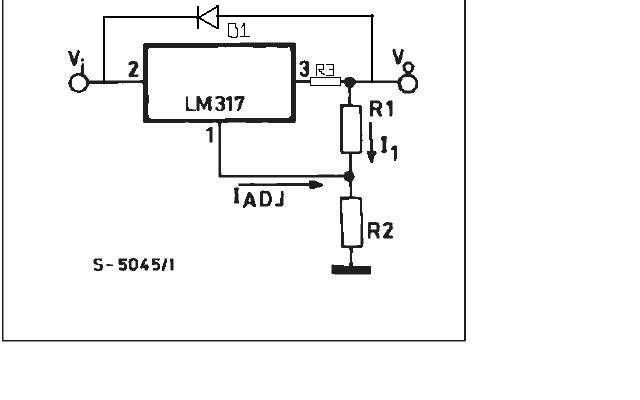

I have worked out if I use a 12ohm resistor, then it will charge at 104mA, this is ok. But how do i work out what voltage will be at the output??
What i am trying to do is modify the existing circuit to charge NiMh batteries.the circuit below is what is currently on the pcb. R1=470ohm, R2=2000ohm and R3=2.2ohm and D1 = 2BL4. They are charging a 6v seal-lead acid battery and i want to replace this with 5x1.2V cells giving 6V.

hi mike,
Checked, the 12R will limit the current to 104mA , as per your calc.
Do you have a 6.8V 1Watt zener in your scrap box?.
You could connect this across the battery terminal points from the charger.
If the charge voltage exceeds 6.8Vthe zener/battery it will start to sink the 104mA and hold the voltage to around 6.8V.
If you dont sink or clamp the voltage in some way, the current limit is going to try to drive 100mA into the battery, the voltage will keep rising until the battery fails.
It will work, but I still don't consider it a good idea, LiMH isnt very forgiving.
The attached circuit is closer to what you are looking for.
Remember to increase the value of R3 to reduce the current.
Eric

Hi mike,
The no load voltage of that circuit should be close to what you want, if not slightly increase R2.

mike,
The transistor requires about 0.6Vfwd base voltage at the rated current.
In the example, they say 1:eek:hm: at 0.6A = 0.6Vfwd.
So for 0.6Vfwd at 0.1A = 6:eek:hm:
R3= 0.6V/Ilim
Is this what you mean ?
Eric
Mike: its 6 ohms , 1Watt

It does work. It doesn't mention1 ohm or 0.6A so I don't know what you are looking at.
You don't need to worry about the output voltage - it will adjust itself to whatever it needs to be to maintain the constant current although as you say it does affect the voltage you need at the input which needs to be 2V or more higher than the output voltage.
