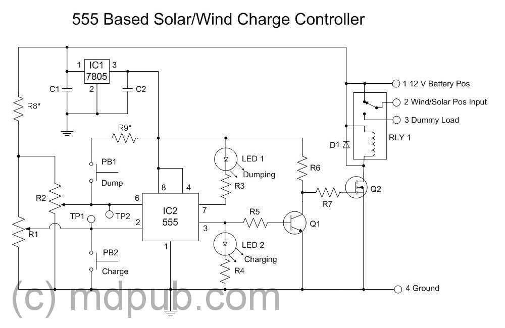

I made a solar charge controller. It worked very well, until I needed to move it to another place and I connected wrong the battery leads to the circuit ... I connected plus to minus and minus to plus. The solar panel was not connected at that moment.
I need to know what parts burned up first, how to find the broken part with a multimeter.
I attached the circuit schematic.

Connect the circuit to a current limited 12 power supply. Limit the current to about 50 mA more then the current that the relay coil would take. Start by checking the voltage on pin 3 of the 7805 voltage regulator with respect to ground. If it is not about 5 volts then break the connection from this point to the rest of the circuit. Check the voltage again on pin 3 of the regulator. If it is still not about 5 volts then replace the regulator.
If the voltage on pin 3 is about 5 volts then measure the voltage on pins 3 and 7 of the 555 and note the results. Also note if either or both of the LEDs is illuminated. Try pressing the push buttons (One at a time.) Make a note of the results and post them in a reply. It would take too long to post the full tree structure of tests to identify every possible failures or multiple failures.
Les.
Voltage measured on 7805 regulator is about 4.95V.
Voltage measured on 555 ic :
- on pin 3: [3.69V]
- on pin 7: [4.04V]
Green ( charging LED) is always on and red (dumping LED) is off.
When i press the charging puss buton, nothing happens.
When i press the dumping button, the red LED(dumping LED) turns on, and turns off when i release the button. So if i hold the dumping button pressed, the red dumping led start to blink ( the blinking looks interrupted, uneven), but the Green charging led don't turn off (it stays on but the light diminishes).
I think the 555 has been destroyed by the polarity reversal so this needs replacing. There still could be other faults but you need to work forward trough the circuit. Can you add the component values, transistor types and the relay coil resistance or current rating in your next post.

Parts list:
IC1 - 7805 5 Volt positive Voltage Regulator R3, R4, R5 - 1K Ohm 1/8 Watt 10%
IC2 - NE555 Timer Chip
R6 - 330 Ohm 1/8 Watt 10%
PB1, PB2 - NO Momentary Contact Push Buttons
R7 - 100 Ohm 1/8 Watt 10%
LED1 - Green LED
Q1 - 2N2222 Or Similar NPN Transistor
LED2 - Yellow LED
Q2 - IRF540
RLY1 - 40 Amp SPDT Automotive Relay
C1 - 0.33uF 35V 10%
D1 - 1N4001
C2 - 0.1uF 35V 10%
R1, R2 - 10K Multi-Turn Trim-Pots
R8-R9 - 330 Ohm 1/2 W Resistors
I get the schematic from https://www.mdpub.com/555Controller/
Thank you!
Post the results when you have replaced the 555. There is a good chance that Q2 and D1 have also been destroyed and a possibility that Q1 has been destroyed.

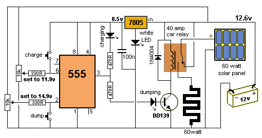

R9 should be placed between R2 and PB1
R8 should be placed between R1 and PB2
R7 is not needed.
All resistors can be 0.25 watt
The output driver can be a simple BD transistor.
CHARGE CONTROLLER
This circuit prevents a battery being overcharged. When the battery is charged, the energy from the solar panel is dumped into a LOAD. This load can be a 12v 100watt globe or a high-power resistor.
You only have to dump excess current of your solar panel is capable of fully charging the battery in less than 10 hours.
If it takes 24 hours of sunlight to charge the battery, this is equal to 3 days of illumination and the battery will accept this low rate of charge.
