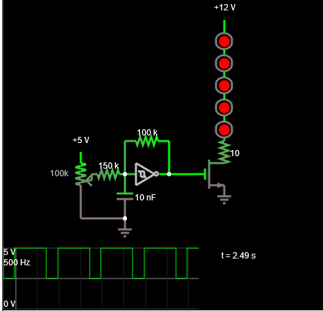

Simple PWM uses LED > 300 Hz for flicker free can use Hysteresis inverting oscillator such as logic gate or comparator.
It depends on your output needs. Try sim. here
Well I ve tried it and so far no issues. The Period of course is greatly changed from 1024μs to 21μs but other than that, everything works as usual.
I was fearing some increase in heat or something...
I also tried using timer2 prescaling to lower the period of my PWM and good results so far
