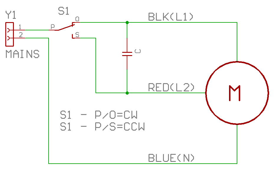

I am trying to figure out how to change the direction of a 2 RPM, AC, Synchronous-Reversible Holzer and Cabot Motor.
Here is a wiring diagram and photo of the current setup:
Basically I just need to figure out what kind of component I need to switch the direction of the motor. Something that can connect between the existing capacitor-switch setup and the motor would be best since I can get the correct outlet and plug for such a connection. I'm including a photo of the setup as-is in addition to the wiring diagram.

Preferably the male plug would insert into the existing switch/capacitor box, connect to the direction changing component, which would connect to the female outlet, which would connect to the existing male plug (direct line to the motor).
Thanks for you help!
Yes, an SPDT switch will work.
It swaps black and red.

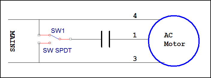

make sure both windings (blue-black & blue-red) are equal by atleast measuring the the winding resistances. since its reversible motor, i hope there wont be any problem.
Most small fractional HP AC Synchronous motors I have worked with would be wired per the attached. I may be wrong but this is how I have done it. I did omit the On/Off switch and the drawing is sort of crude.
Ron
check your drawing, ,may be there is a mistake,
normally in both directions, one winding would be directly connecting to mains and other would be connected in series with the capacitor to have considerable phase difference so that to provide enough starting torque.

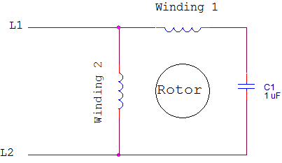

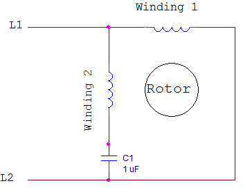

Normally in small fractional HP (less than 1/4 HP) gear motors it is exactly as you stated with the windings spaced 90 degrees apart and a capacitor placed in series with one winding or the other to cause a 90 degree phase lag in the current. Should be like the attached images.
