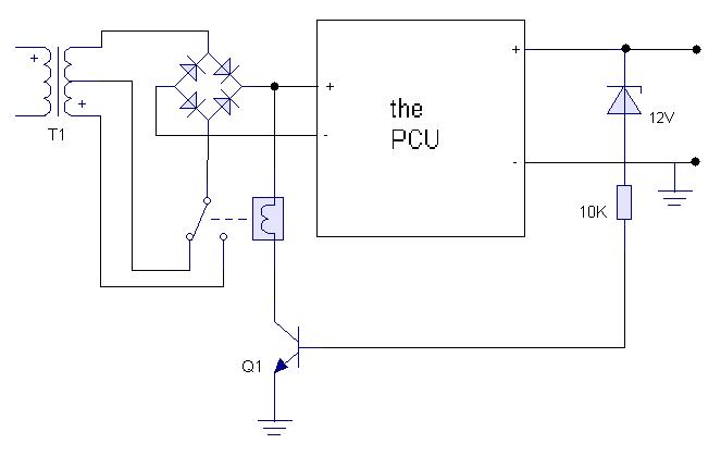

Here's and idea I've had for a tap changer which switches to the centre tap on lower voltage settings to lower the power dissipation.
Its a good idea, but its already used in many bench power supplies.;)

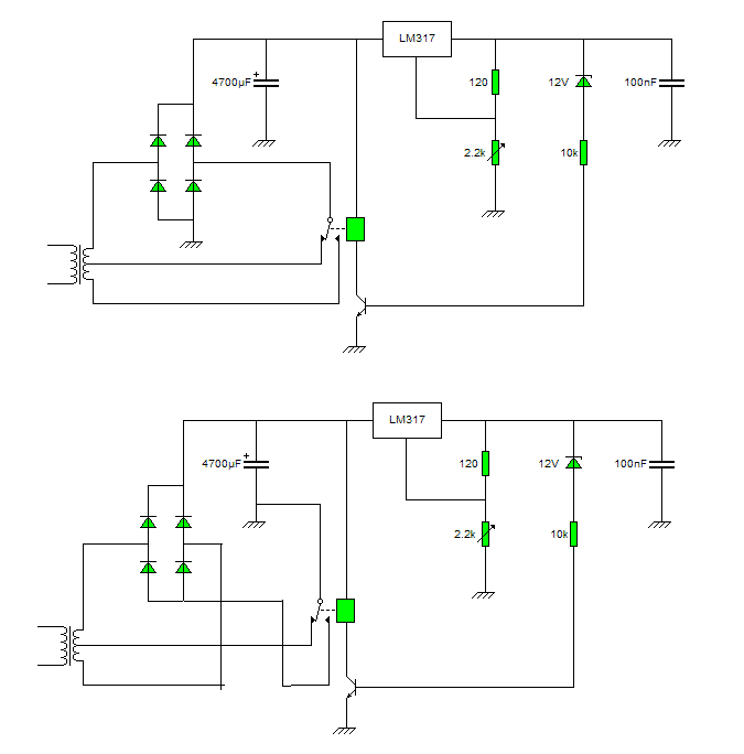

For center tapped secondary, it is usually done like this.

The first attachment is exactly the same as what I origionally posted.
The second is the same idea but it switches the negative line after the rectifier. You could switch the positive line after the rectifier, it doesn't matter.
You're right it's probably better to switch after the rectifier because the centre tapped point only has one rectifier voltage drop rather than two. The disadvantage is that most relays have a lower DC current rating than AC current rating so you might need a slightly larger relay.
lm317-tap-changer-gif.25341
Solid state deisgn is the best option as a transistor is cheaper and far more reliable than a relay. The disadvantage is that you need to allow for the saturation voltage of the transistor and that there will be two diode drops on the centre tap.
Have you considered the maximum secondary current available in these two different configurations where a relay is used for switching?
It shouldn't make any difference to the current rating of the transformer whether you switch after or before the rectifier.
In your original proposed switching arrangement, only half of the transformer is being used in low voltage range. The other half is idle.
Thus the available current is only half of the transformer rating.
I see what you mean, it's acting as a bi-phase rectifier.
What difference does that make?
The transformer has to be able to supply the full current through both windings when the voltage is turned up.
The current rating isn't double from the centre tap to the + or -, it's 1.414 times the maximum normal rating.

If you connect a bridge rectifier to a centre tapped transformer and connect a load from the +V or -V to the centre tap, both halves of the transformer's secondary will be used alternately.
Because the duty cycle through the secondary is now 50%, it's perfectly safe to exceed the current rating. The copper losses are equal to I²R so you can't safely double the current as this would quadruple the power dissipation. To get the same power dissipation you need to increase the current by √2, therefore the maximum current rating increases by √2.
Compare this bi-phase rectifier to a bridge with the load connected from the tap to the +V.

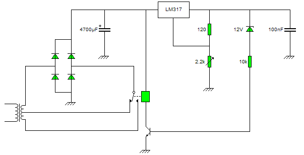

I've made circuit like this, but when the voltage gets more than 12V the relay starts clicking, and the voltage at the output is changing all the time...so anyone can help me...
btw the PSU is with lm723
There are a couple of errors in my circuit.
There should be a diode in reverse parallel with the relay coil.
Another thing I've overlooked is that it could be oscillating because the filter capacitor is being discharged when the coil is activated causing the output voltage to drop slightly resulting in it being deactivated.
I can think of two solutions:
Add a capacitor from the transistor's base to 0V. This might help keep the transistor on for a long enough length of time for the relay to connect to the higher voltage tap.
Add a high value resistor (try 100k to 1M) from the + side of the rectifier to the transistor's base. This should add some hysteresis so when the relay does engage the transistor will turn on even more.
Failing that, are you sure the filter capacitor is large enough?

I would recommend using the solid state version: it should be much more reliable.
You might have to tweak a few component values, remember I haven't tested or simulated any of these circuits.
