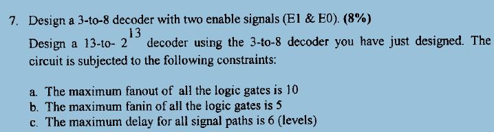

Challenging decoder question
tonald
I have no idea about how to use the two "enable inputs". (the second part of the question)
Thx

A 3 to 8 decoder is a 3 to 2^3.
You enter with 3 bits and it gives you 8 outputs.
He wants a 13 to 2^13 decoder.
You enter with 13 bits and it gives you 8192 outputs.
You can reach that with some 3 to 8 decoders.
For example, 2x 3-8 decoders allows you to build a 4 - 16 decoder. 4x 3-8 decoders, allows you yo build a 5 - 32 decoder. 8x 3-8 decoders, allows you to build a 6-64 decoder, and so on.
2 decods. = 4 bits input.
4 decods. = 5 bits input.
8 decods. = 6 bits input.
16 decods. = 7 bits input.
You have a sequence there. For 13 bits input you need 1024 decoders.
