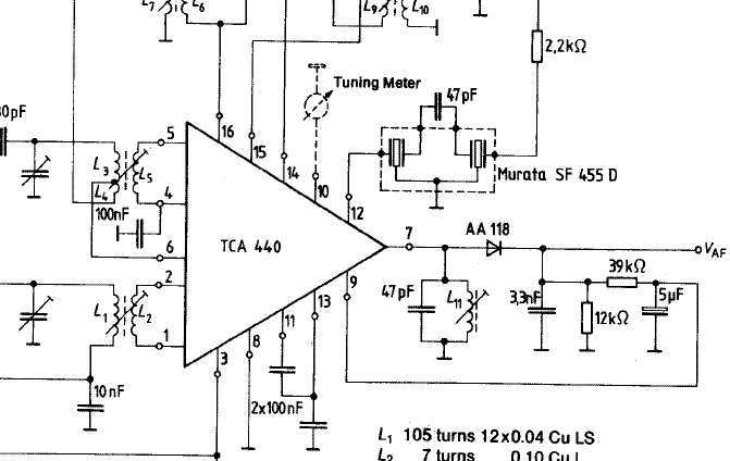

Hi, I'm trying to replicate the following circuit diagram, but I can't seem to find any sites/stores that are still selling the ceramic filter that they use (SFZ455F), so I was just wondering if its possible to replace it with some other ceramic filters.
https://www.qsl.net/pa3fdc/tech/hrx80/hrx80r1b.gif
And just another question, what does SFZ actually mean? I've tried googling for the datasheet and I just can't seem to find any revelent stuff.
Thanks in advance.
This appears to be an older Murata part number. I looked in their most recent Ceramic filter catalog for North America and don't see it there, probably because they have changed over to marketing mostly SMT packages. I found an alternative at Oscilent.com in their series number 739, see part no. 739-455-HL-C, which seems to be a close alternative.
https://www.oscilent.com/spec_pages/Filters/F-739.html
Be sure to check if the package of this part still fits into the circuit board layout, as I did not do that.

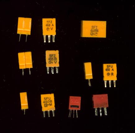

Hi Forever99482,
These are simple old style filters, in/out impedance 3k.
The "F" stands for 12 kHz bandwidth. (+/- 6 kHz.)
They usually come in pairs or triples but sometimes also single.
The orange one's are two three pin filters glued together.
A possible substitute could be a SFD455F from Murata, that's
the red one. It actually has five pins, only one ground pin.
It contains two SFZ455F's in one package.
No matter what you do stick to the 3k in/out impedance.
The 455 kHz center frequency is not critical in this design,
you can replace them with 450 or 460 kHz filters.
on1aag.

Did you meant CFWS455F? But the input/output impedance is not the same as SFZ455F. If the input/output impedance differs from 3k, what effect will it actually have on the circuit diagram(pin 12 and 15).
circuit diagram:
Thanks.
Imagine you replace those resistors with 2k2. secondly these are not meant for handling DC voltage and they recommend coupling caps . thus you can always terminate with a lower impedence like 2k2 after the coupling caps.
How ever it is many years since we stoped dreaming for TCA440 as it was not available in our country. After so long time you have shown a schematic. but I fear that this item will be in short supply or unduely priced.
The selectivity of the filters is chosen to suit the bandwidth of the signal that you are receiving. This receiver project appears to be designed for radio direction finding, being an SSB receiver set up to receive LSB on 80 meters. For SSB, it is typical to choose filters for a cascaded response providing about 2.4 to 3 KHz overall bandwidth. When researching alternate filters, I found that the AM filters available are often quite wide, so I chose the narrowest model, the 739-455-HL-C. This part has a spec BW of 4 KHz at -3dB, so when two of these are cascaded, the net response is likely to be close to 3 KHz. Of course, you can choose any bandwidth you want from the Murata lineup, but I recommend going with something around 3.5 to 4.5 Khz per filter, or even a bit narrower is OK.
The impedance of the filter will affect the efficiency of the match to the 440 IC, but this is not a highly critical match. Note that there is a 3.3 Kohm resistor right beside each filter. If you change this value to be the same as the filter impedance, that is about all you need to do.

Could someone please tell me why there is a capacitor in between the ceramic filters, SFZ455F (both 47pF)? If I change the SFZ series to a CFA series from toko, do I need to change the value of the capacitor?
Thanks.
F1 and F2 are sets of filters coupled by a capacitor. F3 is individual single , but used for oscillation at 455KHz.
You could imagine 2 numbers each of SFZ455F at locations of F1 and F2. Earlier, there used to be single filter with 6 pins with a provision for external coupling capacitor . Perhaps they may be available now too.
Toko Ceramic filters you have selected are too broad like 13+/-3 KHz while sfz455F series are narrow. Whether it would serve your needs ? This replacement amounts that the second part of the filter is not there and thus no need for 47pF.

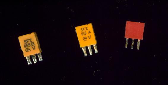

Hi forever99482,
mvs sarma is right, but if you replace each combined filter with two
single resonator filters from Toko you need to include the 47 pF
coupling capacitor between the two individual filters as well.
The combined filter will be narrower and steeper than one single filter,
and it will be close to the original filter.
I also think that you should keep the capacitor value at 47 pF, the
older filter where mvs sarma refers to is the red one, it also uses a
47 pF capacitor between the two individual filters.
But why they use a capacitor with a reactance of 7 k:eek:hm: at 455
kHz to couple two filters with in/out impedance of 3 k:eek:hm: is also
a mystery to me. I think only the manufacturer can answer that
question.
on1aag.
