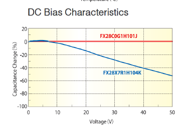

Ceramic capacitors: There are different types of ceramic so the question is complicated.
1) Some types of capacitors, the capacitance varies with the voltage across the capacitor. As you can see in the graph the COG type of ceramic capacitor does not change capacitance much while the X7R is at 50% with 45 volts across a 50 volt cap. In a preamp where the audio is 0.1 volts this effect will not matter but in a output of a power amplifier this effect will cause distortion.
2) Some types of ceramics capacitors are like little microphones. They pick up audio vibrations. They are also like speakers. They can cause movement in air and vibrations in the PCB. If you place a capacitor for the right and left channel close together then the capacitors will "talk" to each other. You will have bad channel separation problems. ALSO A capacitor on the output of the amplifier may talk to a capacitor in the input of the amplifier and cause strange feedback and distortion. (ceramic microphone) and (ceramic speaker)
There are other effects but this will get you started.
A ceramic capacitor has a low impedance at high frequencies so it is used as a high frequency supply bypass capacitor that prevents an opamp or amplifier from oscillating at a high frequency.
I always use a plastic film capacitor to couple audio signals.
