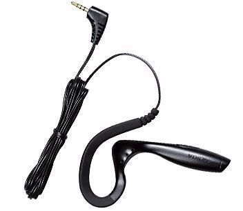

Just wants to experiment. I had a spare cellphone boom handsfree laying around. Tried to connect the earphone part to earphone socket of laptop with wires, it worked. But did't work for microphone part :( . I just heard noise if I used sndrec32.exe to try it.
May be it was just an impedance mismatched between handsfree mike with laptop mike socket. Appreciate if some nice person in this forum shows me how to make it work. Do I need a circuit to bridge the mike and the socket. What kind of circuit it is if it needs.

The boom cellphone handsfree consisted of an earphone and a mike at the end of the boom and has 4 connectors at the jack ( 2 for earphone and 2 others for mike). I tried to connect the earphone/external speaker socket of laptop to earphone connectors of the handsfree and I can hear the music from Media Player. But I could not hear my voice using sndrec32.exe when I spoke thru the mike that I connected to microphone socket of laptop.
Attached. please find the picture of handsfree.

You are right, the jack of cellphone is small (2.5mm) but I connected the jack to 2 larger jacks (3.5mm) for earphone and mike connectors.
Hope you can catch what I meant.
The mic is probably an electret type that needs power.
Maybe you had its two wires reversed so that it had the wrong polarity.
Maybe the laptop circuit is designed for a coil and magnet dynamic type of mic and therefore doesn't provide power for an electret type.
Maybe the mic is wired with 3 wires and one wire is shared with the earphone for power or for ground.

Looks like a Nokia handsfree you have..
Which should be (from tip to ring) Ear,Mic, Ground ear, Ground mic.
As I have tried in the past, the microphone is an electric condenser mic, gardern variety minature. However, I think your notebook simply does not provide plug-in-power, as it is referred to.
Try plugging it into a PC and see how it goes.. Sound Blaster cards do provide plug-in power in the middle ring.

indecided is right, it's a Nokia handsfree.
I have rewired the 2.5mm jack with 2 of 3.5mm jacks and also the order of the rings is like indecided wrote.
I will try to provide the power to the electret mike just like the link by indecided. Rig them on a breadboard and using a 9v battery.
