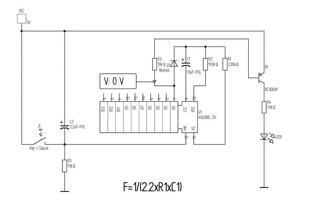

I am trying a monostable circuit for large delays that uses a CD4060.
This is the circuit
I tested it on a experimental plate and works fine, but I do not succeed
to simulate it with Multisim 9.
The I.C. is present in the Multisim library but, after to have created the outline,
when i start the simulation nothing :( happens, all the outputs are immovable.
I need a suggestion from a user of Multisim,
Thanks, Roby.

Your circuit works when you build it so it doesn't matter what the simulator says.
Not so easy, the monostable is just a little part of a more complex circuit that i like to simulate before to make it. However what is the purpose of Microsim & Co?
Bye :eek: Roby
Of course the 4060 doesn't work. It isn't powered. The stupid sim program should have said so.
