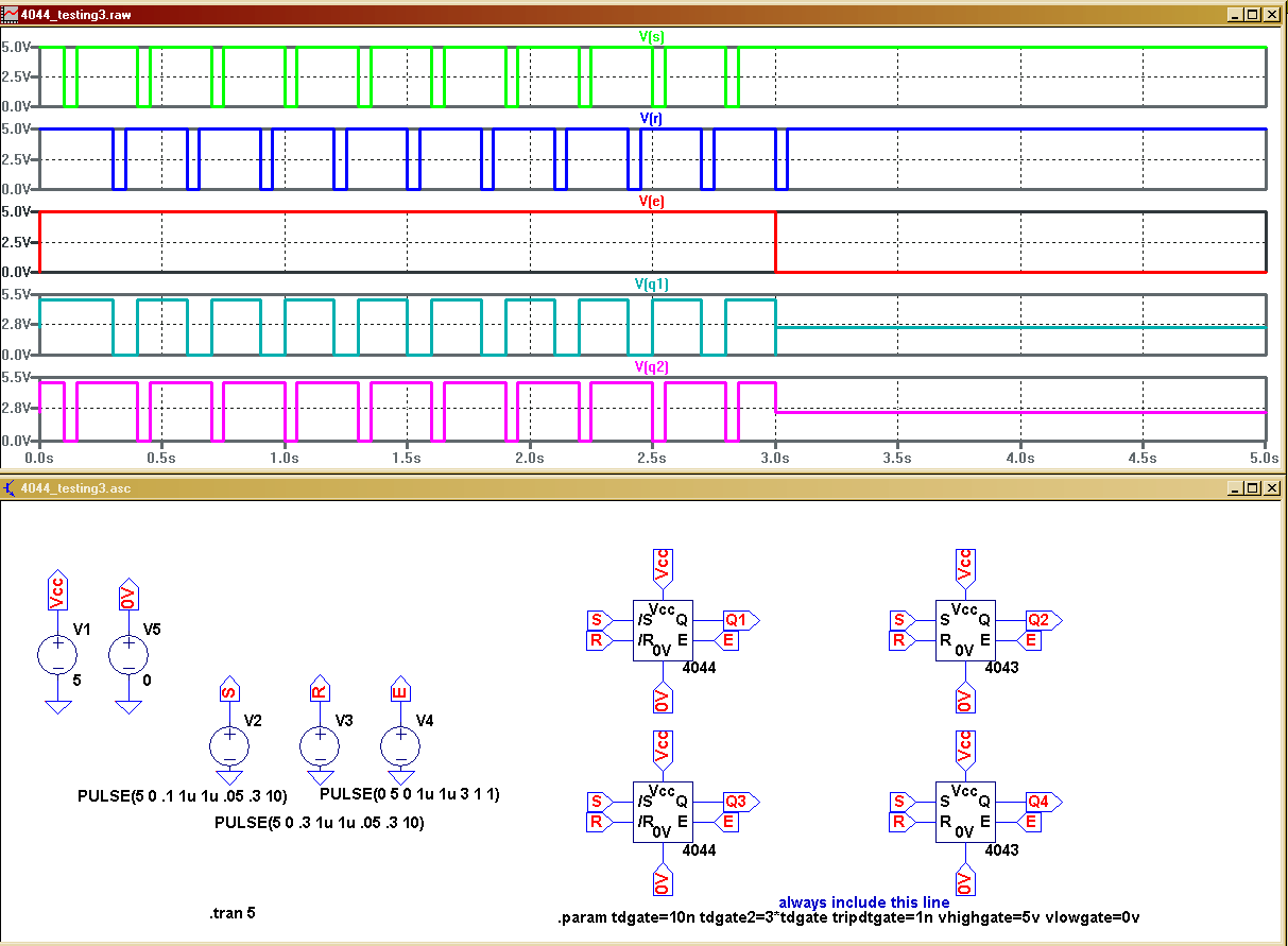

Does anyone have a CD4043 and 4044 spice model?

If you have the d/s for 4043 , you could create an hierarchical model, using the d/s logic diagram.

hi Ron,
This zip is for the 4043 and its hierarchical model, place all the files in the same folder except the 4043.asy, which goes into the Sym folder.
You can do a 4044 using the digital building blocks from the 4043 model.
Lets know if you have a problem.
E

These asc are from my old files, let me know if its enough.
E

These are the asy files.
E
